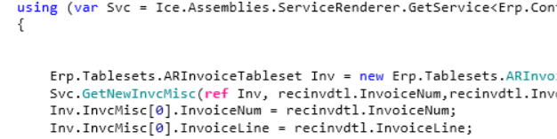

@hasokeric Thanks for the Heads-up .the end goal is to create Credit memo for RMA and add Misc. Line Automatically for the the Invoice, However I can’t able to use Method Directives to call BO AR Invoice. this causes Compilation errors.
There is at least one compilation error.

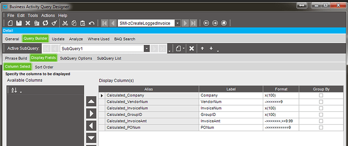

You create an Updatable BAQ lets call it CODE-CreateRMA and you create Calculated fields Calculated_Company, Calculated_InvoiceNum (etc) then you create code inside of the Updatable BAQ under BPM section, under Update (just pick Advanced BPM). You don’t have to have any tables.
Then you invoke the UBAQ from your Method Directive. Use the Updatable BAQ basically as a Function. Then the UBAQ BPM invokes the RMA BO.

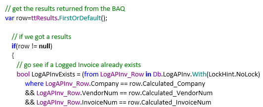

Then basically in your UBAQ you can read the Calculated Columns and get more data and do whatever you want.
var row = ttResults.FirstOrDefault();
if (row != null)
	bool LogAPInvExists = (from LogAPInv_Row in Db.LogAPInv
		where LogAPInv_Row.Company == row.Calculated_Company
		&& LogAPInv_Row.VendorNum == row.Calculated_VendorNum
		&& LogAPInv_Row.InvoiceNum == row.Calculated_InvoiceNum
		select LogAPInv_Row).Any();
	// If no Logged Invoice exists
	if (!LogAPInvExists)
		var LogAPInvSvc = Ice.Assemblies.ServiceRenderer.GetService<Erp.Contracts.LogAPInvSvcContract>(Db);
		LogAPInvTableset ds = new LogAPInvTableset();
		LogAPInvSvc.GetNewLogAPInvInvoice(ref ds, row.Calculated_GroupID);
		string OurMsg = "";
		LogAPInvSvc.ChangeRefPONum(row.Calculated_PONum, true, out OurMsg, ref ds);
		// etc

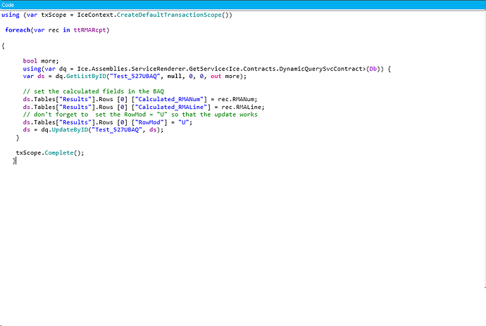

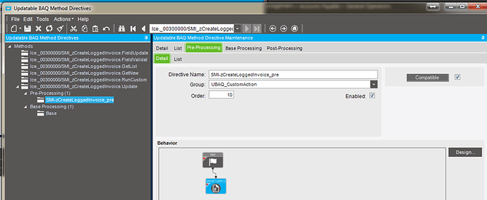

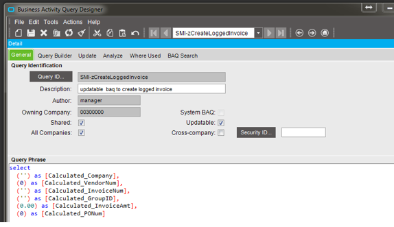

@hkeric.wci Hello , I tried Advanced BPM , However it doesn’t fire the the UBAQBPM, may I know what is the Expression for the Calculated Fields Should be , whether should i use Parameters in Expression?
Just make your calculated fields anything.
Then in the BPM You will fill them out and set RowMod to ‘U’ and then invoke Update.

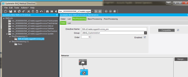

In your Advanced BPM under Update PRE You will then use them:
You can post some of your code, we can help easier, the more screenshots the better

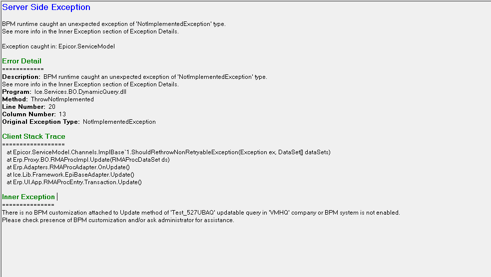

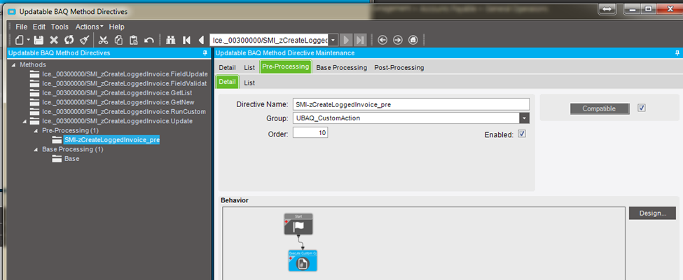

@hasokeric Thanks for the Quick Reply , Now i set the BAQ Calc Fields to Blanks , and Triggered the Bpm , it prompts a exception, refer the Screenshots Below.
Note: I enabled BPM in UBAQ.
BPM Code:
Exception:
@hkeric.wci I Figured it out , I need to enable base processing and make it as Dummy , then Method Fires , is it mandatory to enable base processing ?
Yes, you can also make your BPM as the BASE, but I found sometimes when copying it to another environment Epicor deletes it. Yes you need a dummy BASE.
