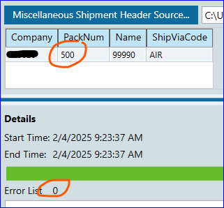

So, I also tried to DMT against the Miscellaneous Shipment Header table to inject a record with a higher PackID (500 in this case)… the DMT accepted it:

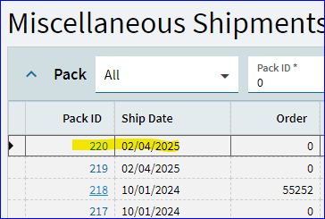

But when I went into the system, I saw it had again, just reverted back to the next sequence number:
I think the problem is that there is no database column that stores the beginning sequence. It always looks at the last used number and indexes for the new added shipment.
I don’t know if there’s an easy way to get around this one. I don’t know if you could create a BPM that would set that PackID number on an added header record? Use it once to set your new starting point and then turn it off? A little over my head.
