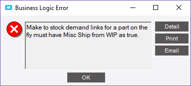

Has anyone ever tried “Misc Shipment from WIP” for a part on the fly? My problem is that I get an error (pic at the end).
Here’s the scenario:
  1. We are building a harness for R&D. It doesn’t have a part number. The job exists in order to buy components direct to it and charge it all to an R&D account. Need some kind of demand link; typically we just do a sales order.
  2. On a whim, I clicked “Make to Stock” and saved
  3. Got an error saying that in order to do this, I need to check “Misc Shipment from WIP.” :open_mouth:
  4. Deal! Now what?

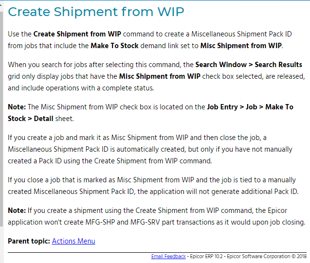

  5. Doing some homework, I learned you can either:
    a. Complete all operations and then in Misc Shipment Entry do Actions > Create Shipment from WIP, or
    b. Close the job and the shipment is done automatically

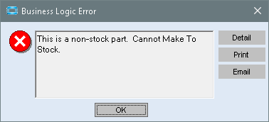

Right, and maybe it is a bug, but this is what happens if I uncheck:
It seems supported. I was wondering if anyone had succeeded with this before.

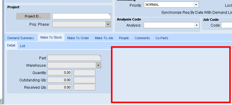

Is there a “Misc Shipment From WIP” checkbox on the Make to Order demand tab?
Also, that must be some advanced module feature. My Job Entry screen does not show those fields:
Not that I see…
If I make a job with an On The Fly part (not in the part table), I cannot create a Demand for stock
How did you do it?
Or is you part in the Part table but just marked Non-Stock?
I think it’s new in 10.2
No, really, it’s a POTF. Like I said, I think this is new in 10.2.something.

From EpicWeb:
