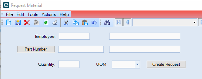

Creating a new UD form with UD table would help. You can generate a Part Number for those consumable materials. Then under UD form, provide selection for Part-Number, quantities and employee dropdown, so that you can know who requested it…
Then with a checkbox, you can generate material request(I have the code, might require some tweaking based on your need). And then warehouse worker can process it.

That’s what I was thinking, making a UD that is like a consumable requisition. Could you share your code with me? To base myself on it and be able to create one that helps us?

Have a look at this, I queried few tables to base my requirements, in your case you can default some values.
Let me know how this goes…
We made a generic UD10 screen for engineering parts. This screen just writes UD10 record. Then a bpm makes a STK-STK queue. The problem we ran into is that on hand builds up. If the consumables are an on hand quantity then you want to make something that will do a STK-UNK and clear the quantity being delivered. I don’t know if that is possible with a material queue. But you could just use the UD record as your own queue and build an updatable dashboard that was the consumable queue and did a stock adjustment and set a checkbox when it was processed.
Yes!! that’s right, we plan to use a material adjustment after making the warehouse transfer.
