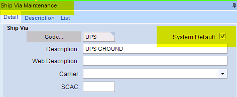

But in reality, we just set one of the Ship Vias as the default. This can be done in a couple of places. The Ship Via Maint. (for the base default),
Country (for overriding the base default, with a country specific one),
Customer (all orders and packers for this cust default ), or Supplier (all POs for this vendor use this as the default )
[ you get the picture ]
ok, so no way to make this optional vs required, just set a default. Thanks
