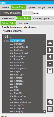

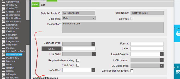

I am running a BAQ and need to pull the column “InactiveToDate” from the “AC_SegAccom” table to display on a dashboard however when I go to select this column it doesn’t appear. I’ve checked the extended properties and it exists inside the table
When I go to select the column inside the BAQ it isn’t there.
Is there any reason as to why the column exists but doesn’t appear for selection in a BAQ?

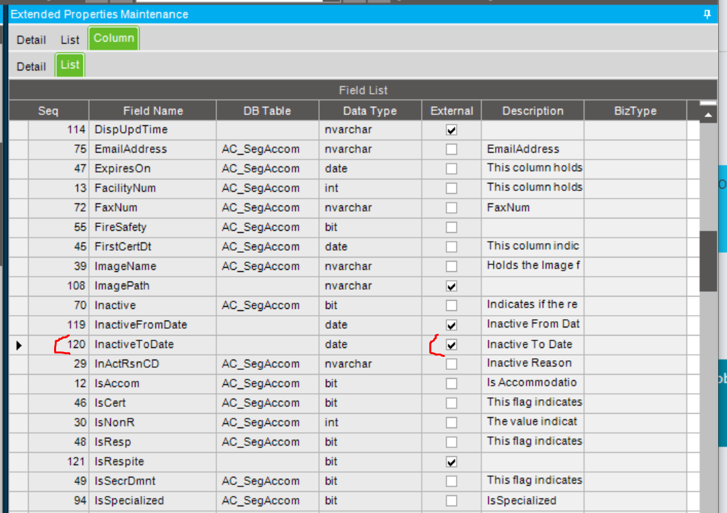

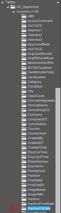

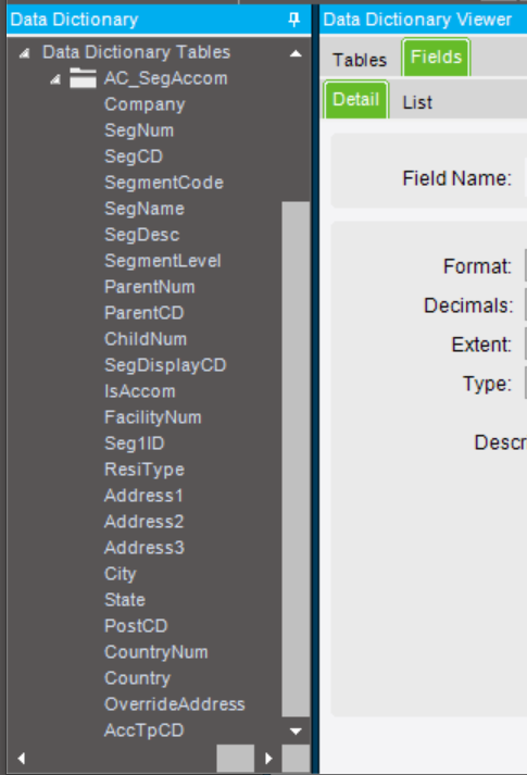

In the data dictionary viewer under the AC_SegAccom table it doesn’t exist either:
It is not a calculated field to my knowledge. In the BAQ I have multiple calculated fields and it is not one of them.

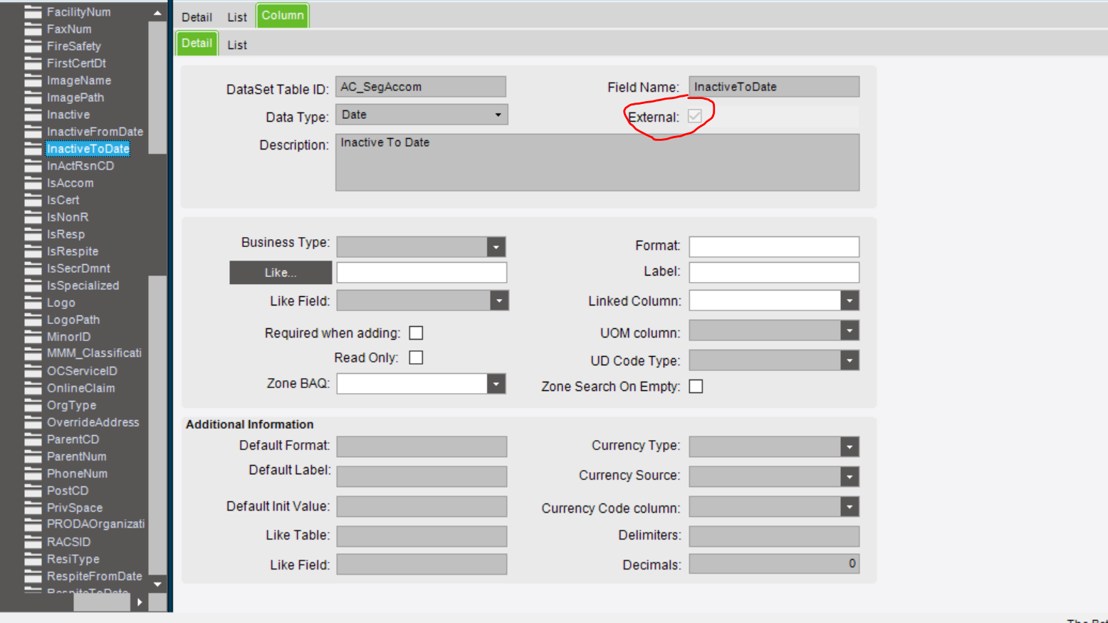

I did notice on the extended properties view the column’s external box is ticked. There are many columns that are externally ticked and don’t appear in the data dictionary.
I have requested a Data Regeneration however I have to populate the new columns under the AC_SegAccom table but they aren’t showing up so this process can’t go ahead until I’ve created the new columns. Is it something to do with these columns being external, if so how do I manage to put them under the AC_SegAccom.

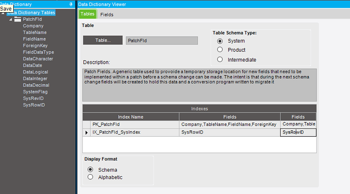

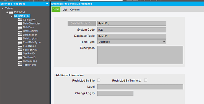

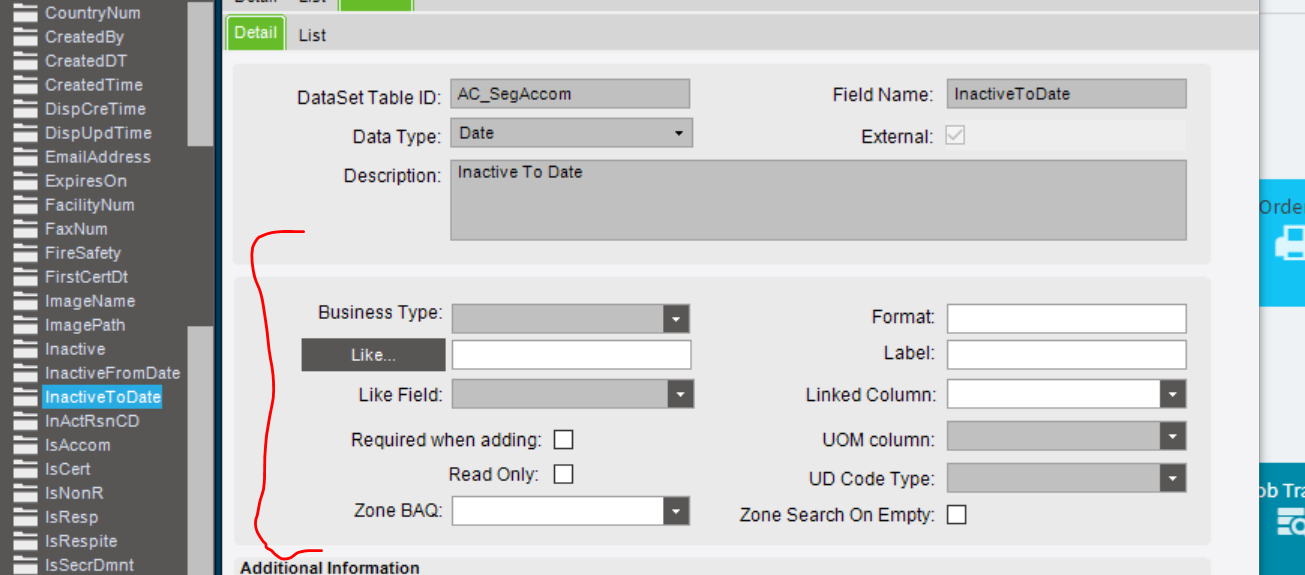

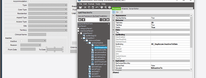

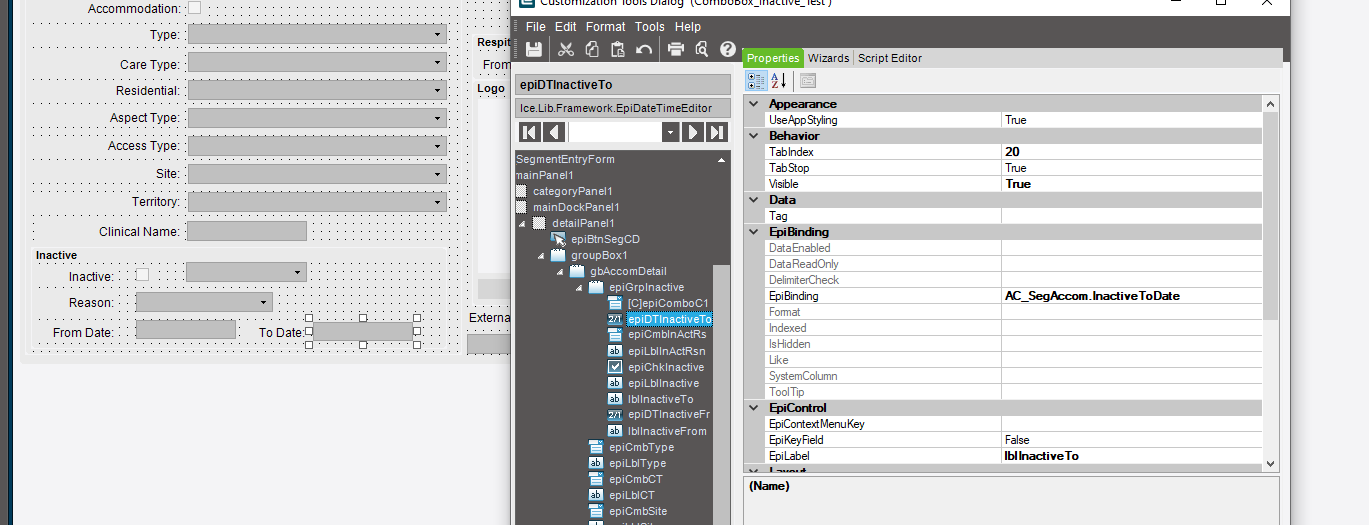

This is what the extended properties shows:
This is in the data dictionary:
It doesn’t seem like they’re connected, I am unfamiliar with this though.
Create yourself a BAQ to look at the contents of the Ice.PatchFld table.
If my guess is correct, you’ll have entries where TableName = “AC_SegAccom” and FieldName = “InactiveToDate”

Understanding the architecture of how epicor writes to the DB etc is something I am not very familiar with. I have a date dropdown here:

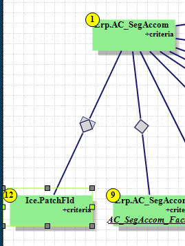

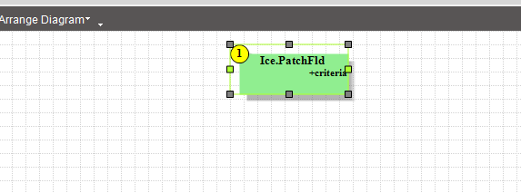

I have below the AC_SegAccom joined to the Ice.PatchFld
The only columns I can see that are a date type is the DataDate column.

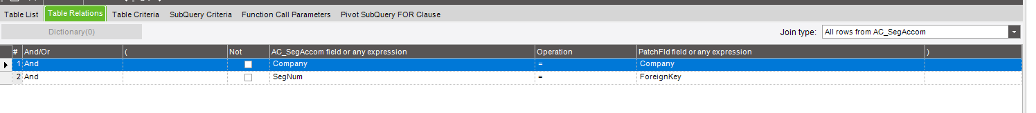

The table relations are based on the below. Is there a way I could assign the InactiveToDate to equal the DataDate column in the Ice.PatchFld table?
You may want to consider creating a subQuery for the patchfld records.
  1. You can create Calculated fields with names and types you want.
  2. Eventually, PatchFld entries will be migrated to the new table. Eventually. And this will break your BAQ. Putting it in a subQuery will give you one place to fix it when it does.
Create yourself a fresh BAQ, display all columns, and see what you find. You’ll either find that there are rows with the matching table and field name or you won’t. No point trying to join to that table in BAQ until we know whether it contains the data you’re interested in.

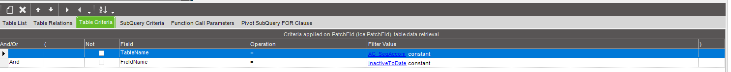

I have ran this below on the PatchFld table in a new BAQ:
Can you run it again but without any criteria. That’s currently showing no records and supporting the idea that it’s not a DB field and instead it’s something calculated in the business object.

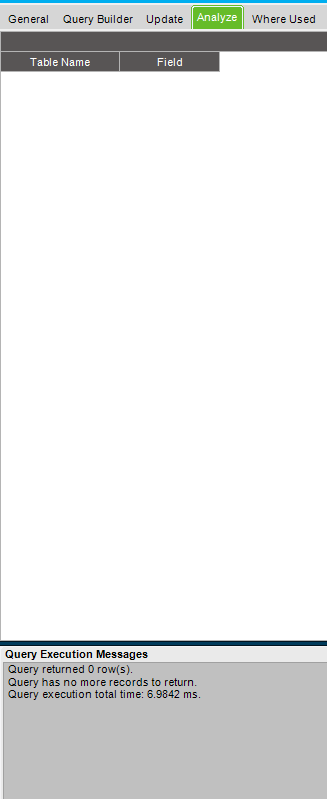

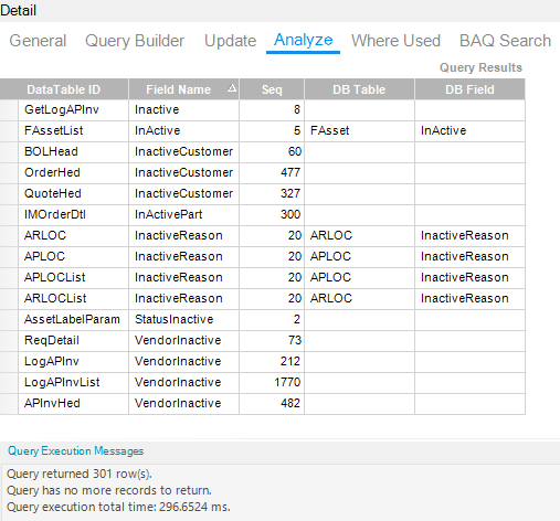

Appears to be no InactiveToDate field, these are all the AC_SegAccom fields that returned with no criteria.
Run it with the field name too so you can see if any fit. If it’s not there, it’s either pulled from somewhere else or calculated from somewhere else.
Honestly, I’ve always seen fields in PatchFld show up in BAQs, just not in code via DbContext or, gulp, SSMS
A BAQ for zDataFields looking for fields with the string ‘inactive’ in it does not show the field you are looking for. It must be calculated.
