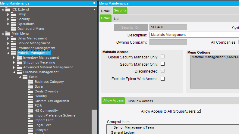

This is the Menu that he is trying to access:

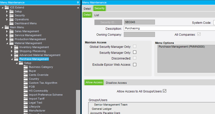

He is included to the group where the Menu is located:
It is also accessible to all groups/users:

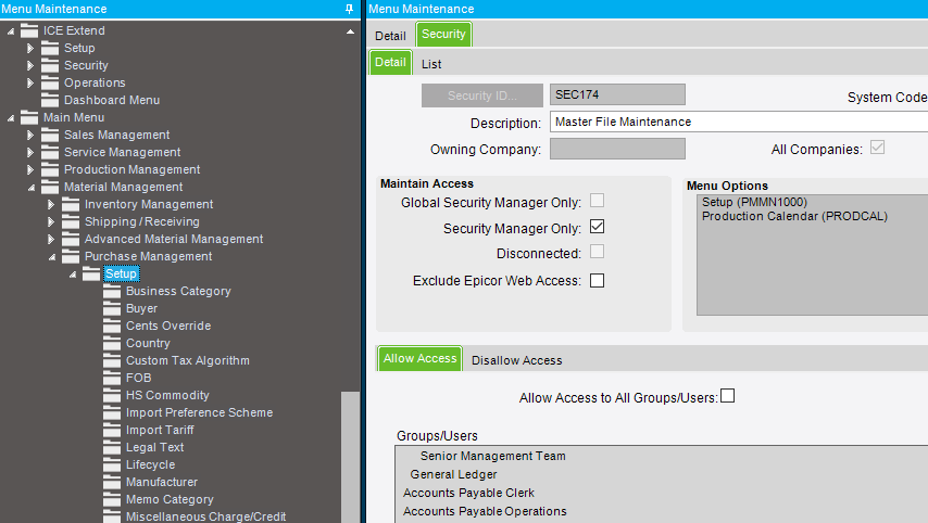

What about Setup?

Setup is Unticked.
I ticked Allow Access to All Groups/Users and unticked Security manager Only and it worked!
Will there be a problem if I unticked Security Manager Only?
