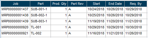

When MRP ran last night, I got the following:
So… I am trying to figure out:
Why there is only one job for SUB-001-1. There should be another one to feed into TL-002 (or the first one should have Prod. Qty = 2)
Why there is no job for SUB-004-2?
Anyone have any ideas?
