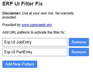

Here’s a proof of Conncept browser extension.
Link should be good for 7 days.
Use at you own risk, blah blah.
Unzip to a folder YOURFOLDER.
Open extensions in Chrome.
Click developer top right.
Load unpacked - select YOURFOLDER.
Load part entry (or add your page if you added as directed below).
Win.
It’s chatty in console, but you can see it work.
Currently only works against PartEntry. You can add any additional targets in the array at the top of content.js
const patterns = result.urlPatterns || [‘Erp.UI.PartEntry’];
ie. const patterns = result.urlPatterns || [‘Erp.UI.PartEntry’,‘Erp.UI.JobEntry’];
Or open the extension (bomb icon), add a new pattern.
