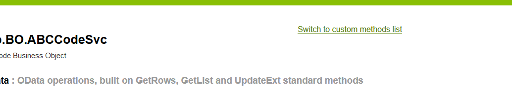

Thanks, Mark I had not tried that. When I try to switch to the custom methods list, however, it reports that it is “fetching resource list… Please wait.” but so far has not completed, seemingly occupying the browser doing something. Guess I will wait a while longer and see if it ever finishes.
