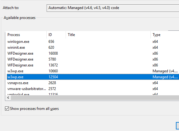

Missing wpw3 process when debugging BPM in visual studio
On the server try the command and see if you get the process.
I got the process ID, but then when I attach it to Visual studio, the break point will not hit. I think it maybe because of Visual Studio 2017. Next thing I will try is Visual studio 2015.
Updated… if the breakpoint doesn’t hit, try the steps in the doc on page 803
