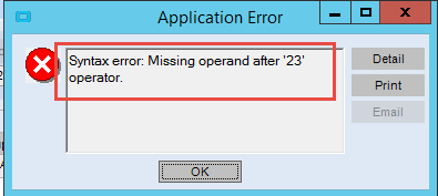

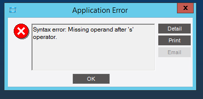

I’m getting the following when launching 10.1.400.23 as the modern shell. I don’t see it when using the Classic shell. Everything seems to work after dismissing that error message.
The only difference between the properties of the shortcut, is that the one that launches the classic shell includes /classic in the target. They both refer to the same sysconfig file, and startup in the same directory.
Here’s the details of the error message:
Application Error
Exception caught in: System.Data
Error Detail
Message: Syntax error: Missing operand after 's' operator.
Program: System.Data.dll
Method: Parse
Client Stack Trace
at System.Data.ExpressionParser.Parse()
at System.Data.DataExpression..ctor(DataTable table, String expression, Type type)
at System.Data.DataTable.Select(String filterExpression)
at IceShell.Apps.Home.HomePageApp.loadTiles()
Logging in as a different user, and I don’t get the error. So back on the original user, I purged all personalizations. Error still occurs.
If I go to the Settings -> Home Page, select the Reset Layout (and check the “Reset your home page to default layout” checkbox), and click the “OK” checkmark, I get the error again.

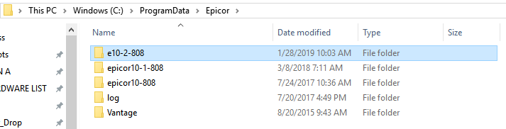

Whatever instance you are having problems with. Sometimes the clear cache doesn’t get everything. I’ve had to do this with the old customizations hanging around problem. Your’s is different, but it re-writes itself when you log in again, so it doesn’t really hurt anything.
ProgramData is hidden so you have to change the setting to view that.
I had the same issue and manage to resolve the issue. The name of the AP Group is containing an apostrophe like FA08’23. You have to use ’ instead of '.
