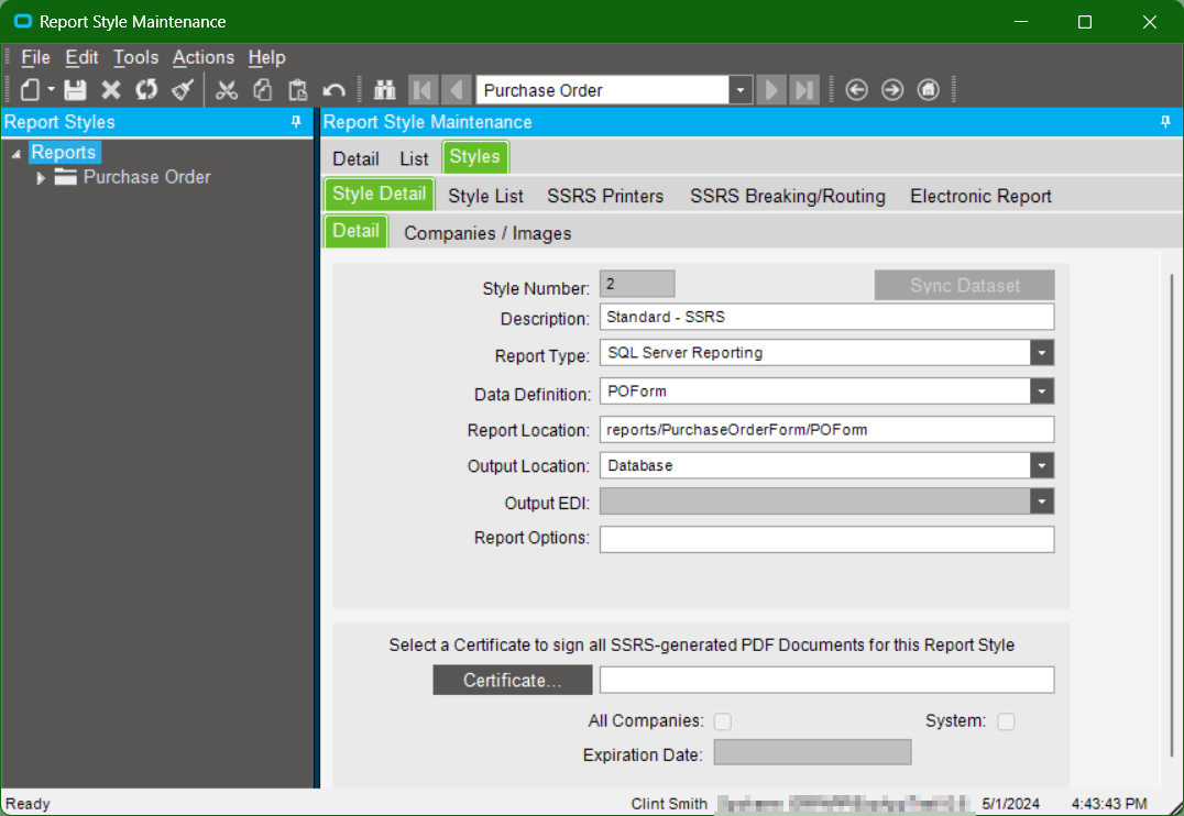

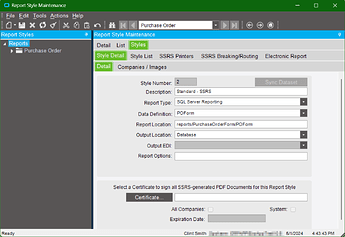

In Epicor, the word “template” can have at least 3 different meanings, so no problem. For your specific question, which I’ll paraphrase into “how do you change the wording on the printed Purchase Order form”, you will need to be able to modify the Report Style using the SSRS Report Builder, and possibly also changes to other fields in the Purchase Order, Supplier, or Part tables (if you need to add data to any of those locations).

If I understand your question correctly, you are asking about the SSRS file used to create the Purchase Order output which resides in/on the SSRS Server. You should be able to find and update this using the details in the Report Style Maintenance UI.
