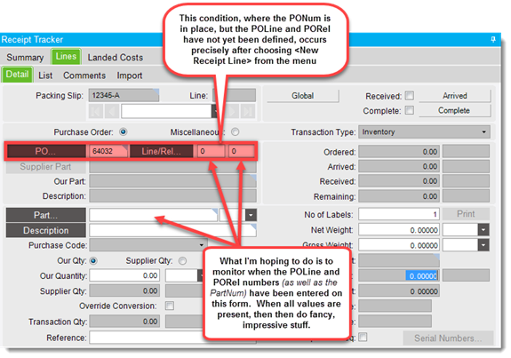

Basically what I’m trying to do is monitor three fields on the Receipt Entry form. If all three of these fields contain values, then allow other fancy code to happen:
I remember that my first approach on this was to simply define the “EpiNumericEditor” and “EpiTextBox” fields, then determine, respectively, if they were anything other than zero, or blank. However, I have since forgotten what method I used to “monitor” this condition.

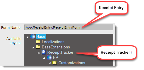

Your image is of the Tracker form, not the Entry form.

Yet - I’m launching the Receipt Entry form, so it’s a bit odd when looking at something like this:
I’d say that I’d need the trigger to happen in the scenario you described in item 2.3 ----> after the part number is retrieved when the PO, POLine and PORel are entered.
