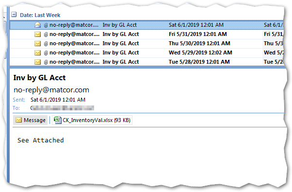

I have the a customized version of the SSR scheduled to run every night at 12:01 AM, with a dynamic date of “Yesterday”, with the report emailed to me. Then I have a record of the QOH and Cost for each item at the end of each day.
And the SSR runs at 12:01 AM on the first of every month. This gives the Month End numbers
