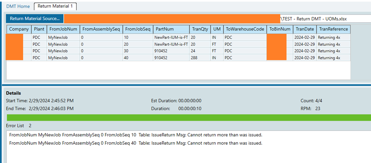

Part 2: The issue

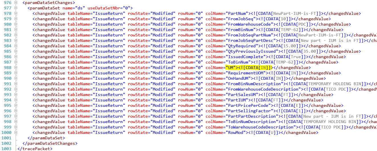

DMT for “Return Material” is ignoring any UOM that I enter in.
To plagiarize myself:

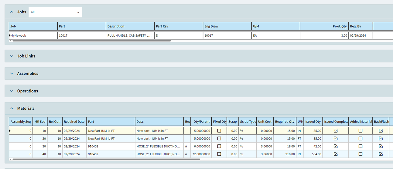

We issued 132 inches (11 feet) of a part.
Tried to return 66 inches of it via DMT.
The DMT errored saying cannot return more than was issued.
Well, last I checked, 66 < 132.
Tried it in the UI (not a DMT) and it worked fine.
Then it hit me - it’s trying to return 66 feet instead of 66 inches. And I had specified inches in the DMT.
I had a few more parts like this where I was returning half of the quantity (all in inches), so I divided them all by 12, and then it worked fine.
So… this sounds like a bug. I can’t seem to set the UOM properly in the DMT for Return Material.

On Return Material and UOM, is there any sort of custom units conversions involved between stocking uom that might ‘be in the way’ of reversing the transaction? Is it only with certain materials or certain uoms or does it happen with all of its dimension? From your description at least, it feels like there is something unique and upstream creating some sort of UOM restocking confusion. Is there any unique process associated with these problematic materials within inventory control - by way of Part Class, Part Number treatments, BPM’s, Functions etc, that could be entangling?
That was my first thought, that DMT is using the IUM, when I read your post about what was happening. It sounds like there isn’t a UOM conversion being called at all.
