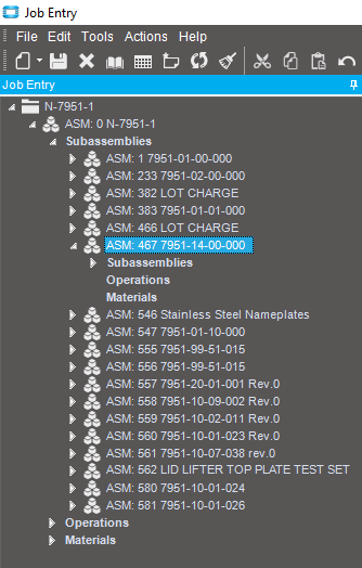

New to the forum and Epicor. I was wondering if there was a way for me to move a certain section of a Job Entry onto another job #? I am dealing with a job that has 650 ASM Seq and I want to move ASM seq 467 - 542 onto another job#, is there a way I can do this? The work is in currently ongoing. Any help will be appreciated.

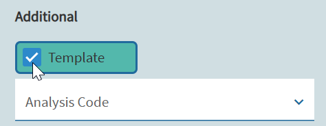

If not, you can mark an assembly as a ‘Template’, which makes it available in the Get Details process.
You could mark the assembly/assemblies as ‘Template’, add a new Assembly to the target job, then ‘Get Details’ to pull in the Subassmblies, Operations and Materials.
Screenshot is from Kinetic, but the same function is available in Epicor 10
Finally, delete the original assembly from the source job.
