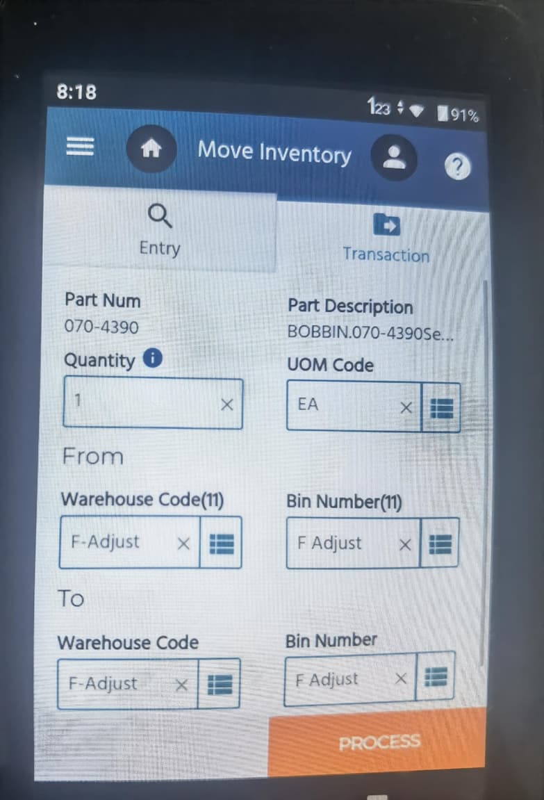

**The Operation in EKWW Now:

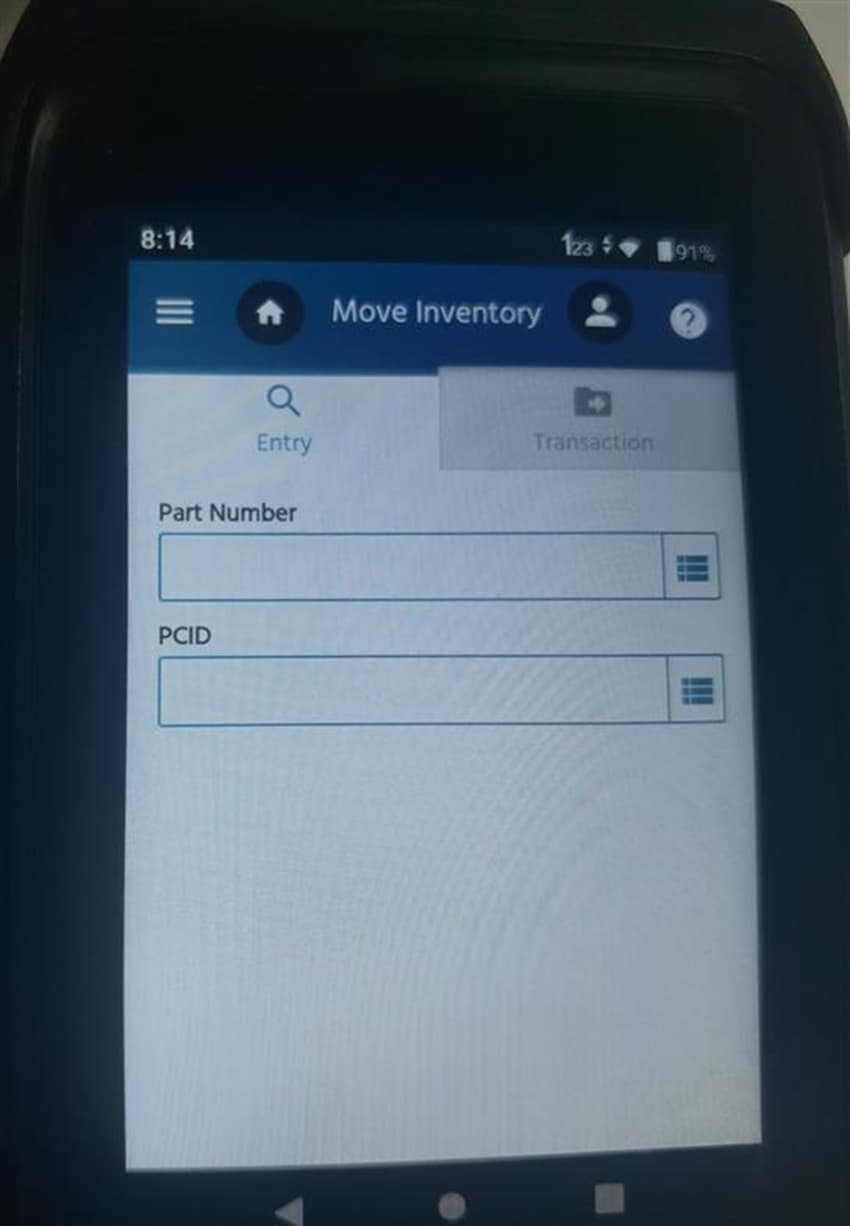

Open Move Inventory Menu and scan QRCode, the information of Quantity, UOM, etc. will auto fill in the relevant fields. Then operator need to fill the “From Warehouse Code”, ”From Bin Number”, “To Warehouse Code”, “To Warehouse Number” manually.
Our Warehouse operator think this is a cumbersome workflow. For example, there are 100EA parts that we need to move to Warehouse B, Bin B from Warehouse A, Bin A, in this workflow, operator need to input “From Warehouse Code”, ”From Bin Number”, “To Warehouse Code”, “To Warehouse Number” every times, which means 100 times. That is unacceptable.**
We suppose if operator can input the “From Warehouse Code”, ”From Bin Number”, “To Warehouse Code”, “To Warehouse Number” information first, then scan the QRCode, So that operator only needs to input the warehouse & bin information 1 time whatever how many parts he need to move inventory.

Can you add QR codes to the bin locations that mimic the input steps?
WarehouseCode, Tab, BinNun

Standard (maybe AMM?) functionality includes put away transactions after a PO Receipt and your screenshot shows you’re using Mobile Warehouse. I think you may have more capability than you realize. I would almost wager that you have these very same transactions pending in the material queue now. unless you are doing Receive to Location when you do PO Receipts. That bypasses this process.
Thanks Joe, because maybe the 100EA materials belongs to different lots, they have different Lot Number. If transfer them in one process, the lot num will be same one
