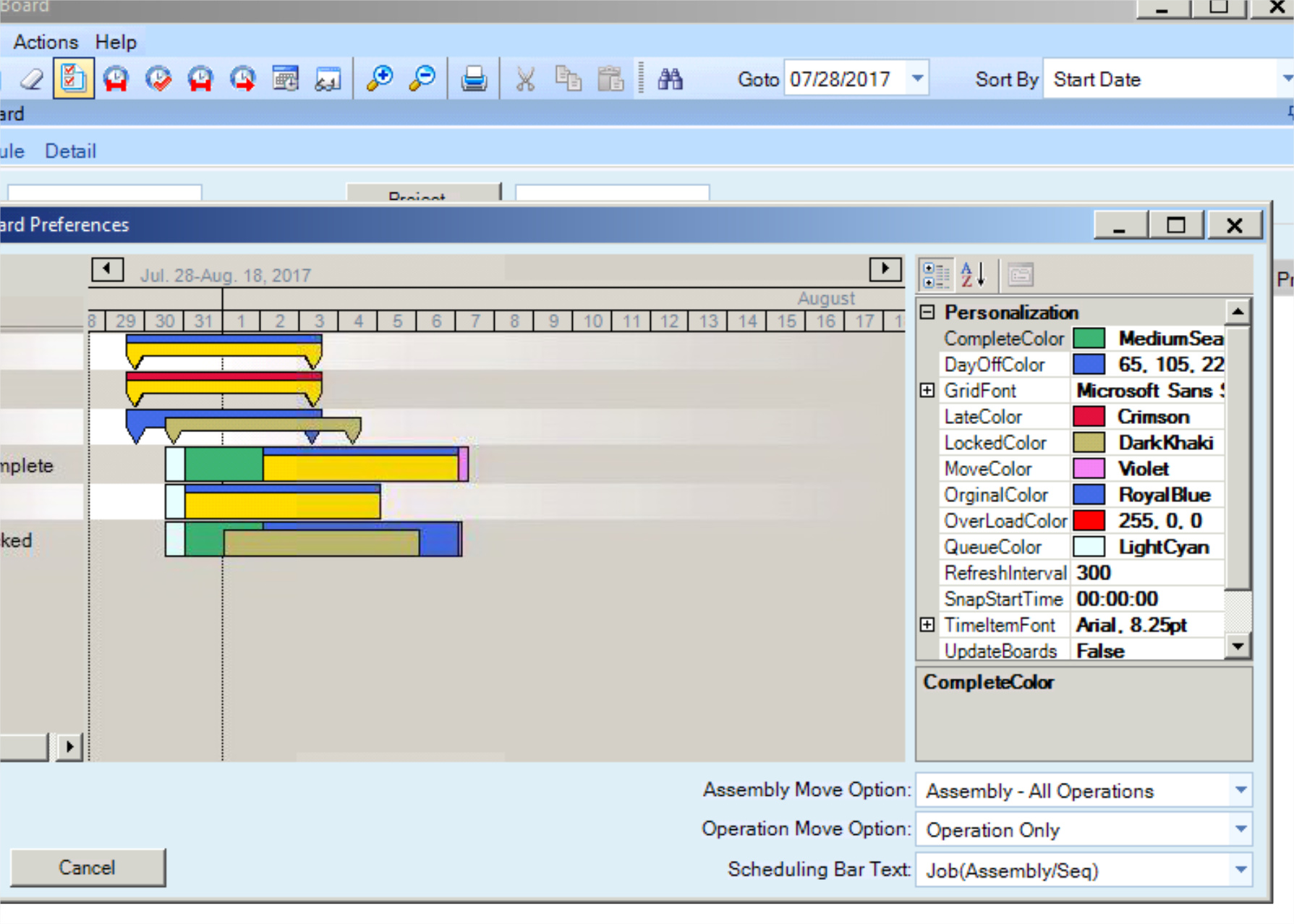

After some additional training in the use of Epicor scheduling, I want to change some defaults in the Move Job form accessed when moving a job in the resource group scheduling board. I can change the finite capacity check box default to true thru a form customization. I can’t find a way to change the Move Option drop-down default from “Operation Only” to “Branch - Subsequent Operations”. Tracing doesn’t show anything I can use a BPM on. I can see the ScheduleEngine.SchedTypeCode has a value of “BS” after I change the drop-down manually, but can’t find a way to make it default that way. Has anyone found a way to do this?
