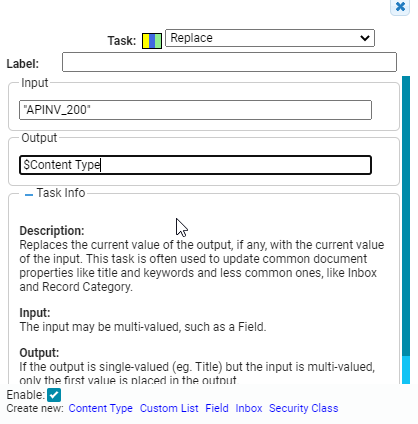

Search and Replace are the tasks you want I think…
Search
Replace
It’s “Document Name” and you can set it to a variable to be used in subsequent tasks if need be - where you can also do some text manipulations to change it’s name if you want.

So I don’t get where you can reference this file name which I know is going to be present in ECM and execute a work flow on it? How does the Replace know it is executing the Content type change on the document that has the Filename found in the Datalink above?

Going on this, I see where you are stuck. The workflow is for one document, and at the time it is running you are working with the Schedule Letter. There is not (that I can find) a task to allow you to perform an ‘action’ on another document except for “Search and Update”, and that only allows for changing the Content Type metadata, not the system metadata like $ContentType or $WorkflowID. And, the package related tasks seem be lacking this ‘add another document’ function as well.
