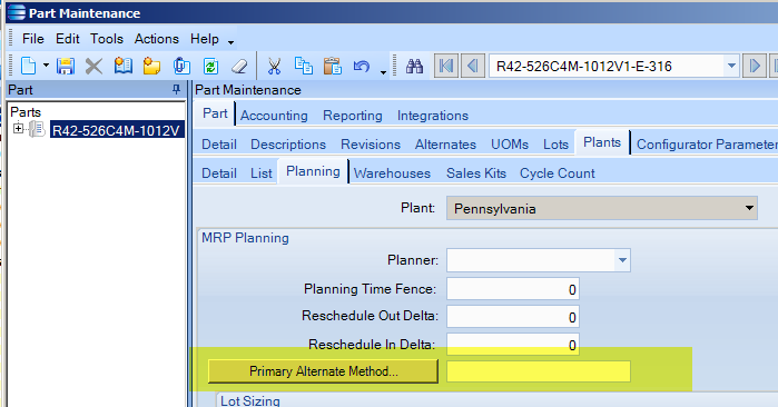

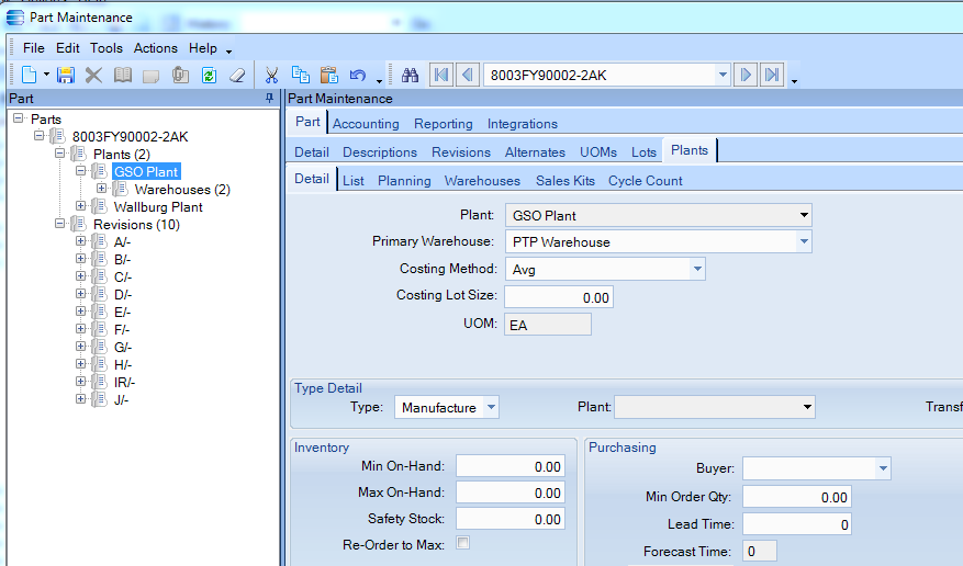

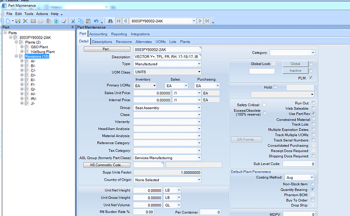

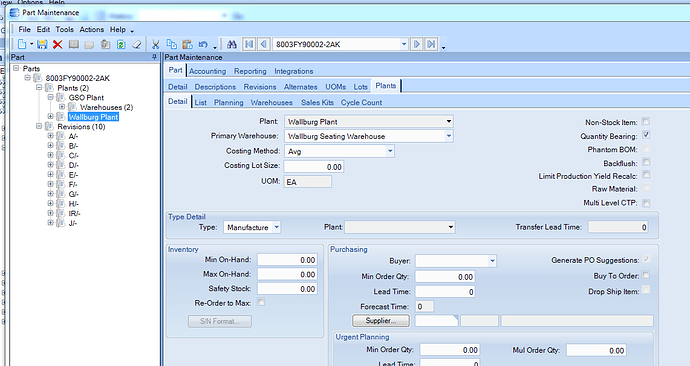

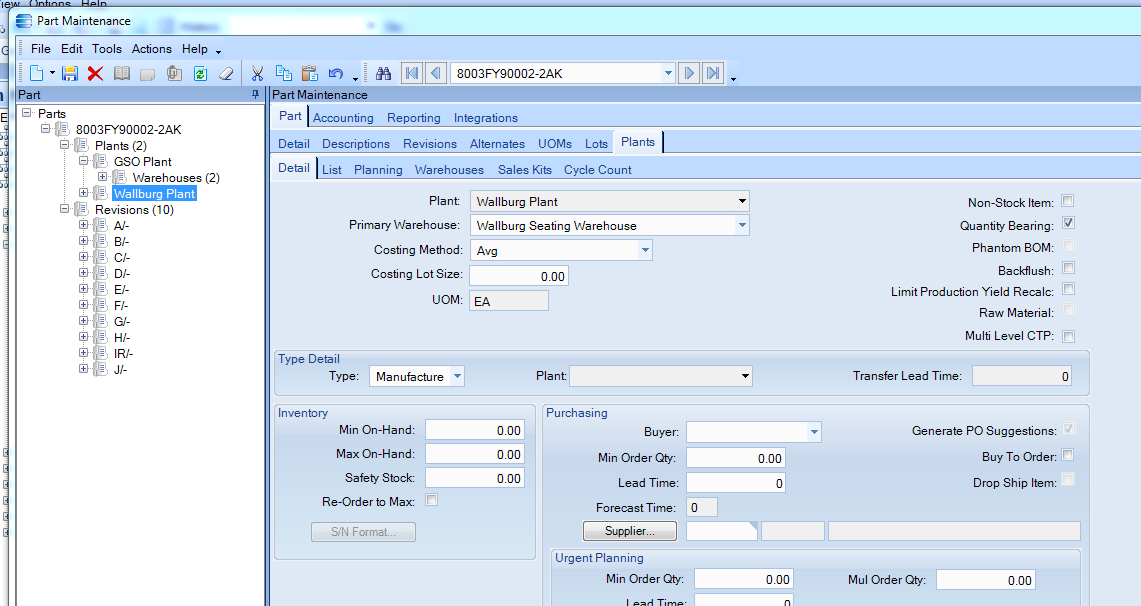

We suspect your MRP is choking because both part plant tabs are setup as Mfr. and you have one method on one of the plants. If Mfr in both, setup an alternate rev on the less used plant for Mfr and then on Part Plant Planning tab pick the alternate method as the primary alternate method. Note, if you do the indented bill with the Alt Method you do not get the listing of the lower level parts… a bug. Once again, job security. :slight_smile:
Nancy

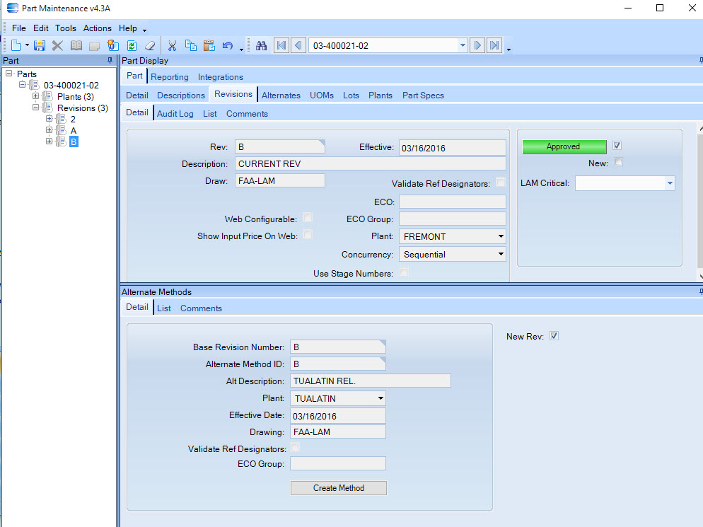

Correct, under the rev tab, choose the rev and then click on Alternate. If you have an Alt Method for a plant, then you need to populate the Planning tab for the alt method Plant.
