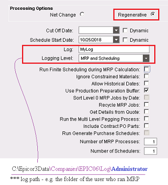

Tried specify higher logging level and checking logs for any errors or references to your part(s)?
e.g

Like @bordway said, getting those Log files is key. And if you run MRP just on the TL-021 part, it will make it easier to read.
Two very quick checks are
  • the log file may give you the error.
