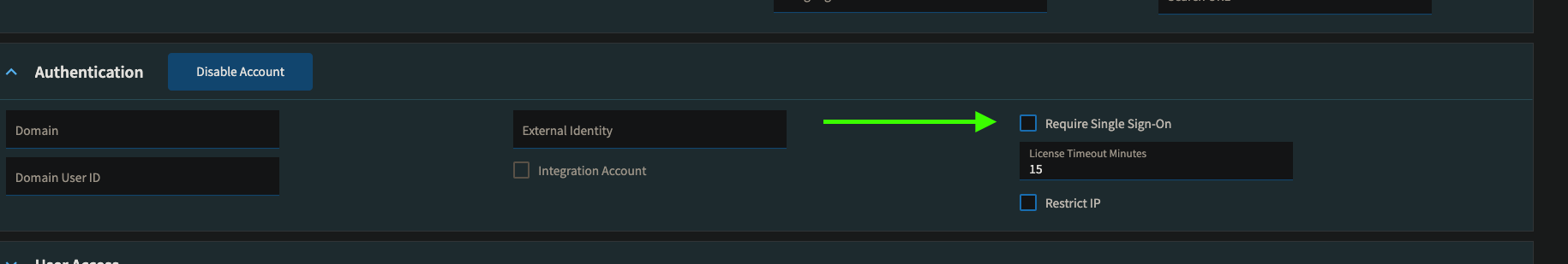

Make sure this box is not checked for the account the TaskAgent is running under

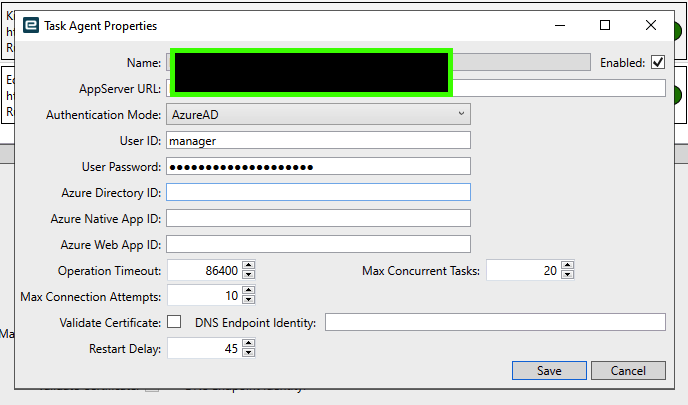

Or your other option is to allow the TaskAgent to sign on with SSO. Just need to fill out this out and change the auth to AzureAD (if thats what you are using for SSO)
