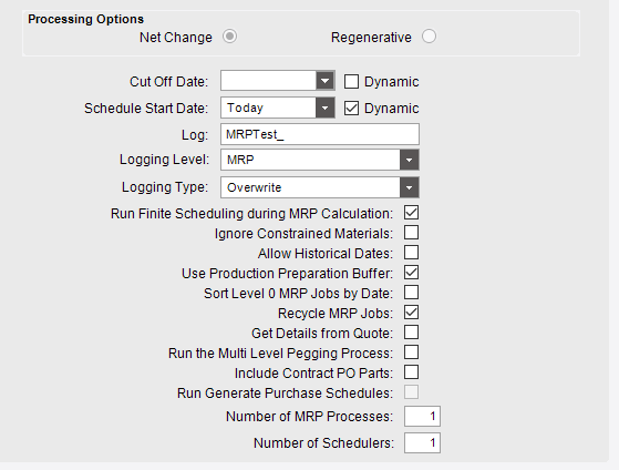

MRP is not creating suggestions for a part and I’ve done some troubleshooting and don’t know where to continue digging. We’re on 10.2.500.23.
When I run part specific with the below settings I get the following error in the logs.

I disactivated all out BPM’s and still got the error.
I ran the user conversion 750 (XAFixAssmPointersForE10) and still got the error.
In a desperate attempt at a solution I deleted all the jobs with demand for the part and still got the error.
When I run MRP with the only change of settings of Not Recycling MRP Jobs it generates the demand without an issue. When I turn it back on and re-run MRP it generates the error again.
That these MRP settings have not been an issue for years. I feel like there needs to be an issue in the data somewhere I just have no idea where else to look.
