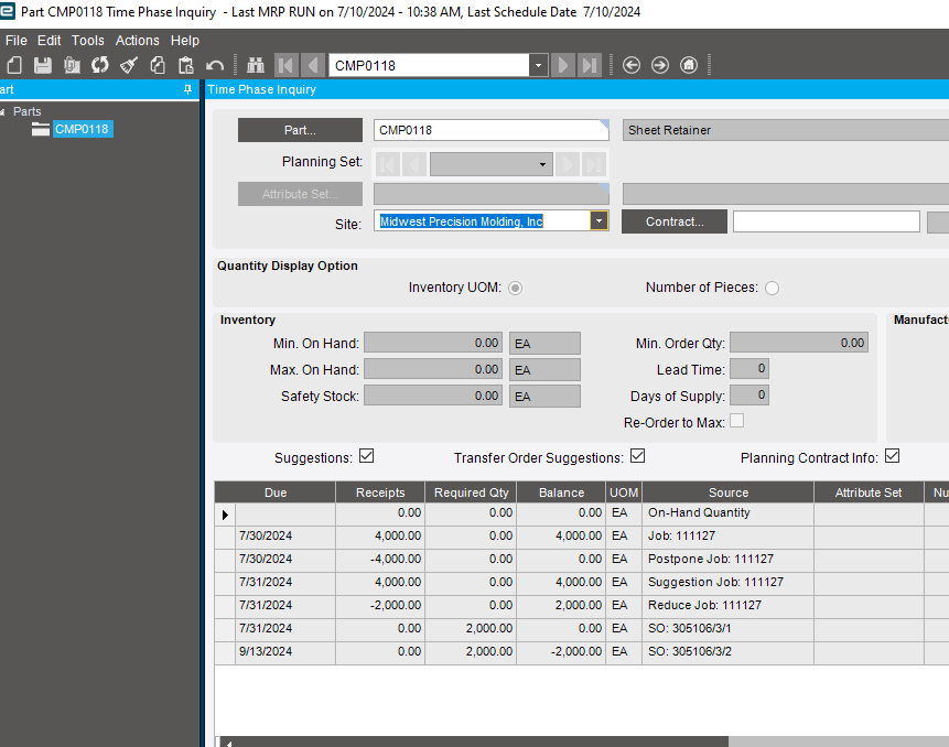

I must have something set up wrong cause our MRP is not working how I need it to. I have parts set up to come over per release. (I am sure this is the issue but don’t know what to put there to fix it). On this example there are 2 releases 2000 each. Today we firmed one of the jobs and added 2000 and deleted the other MRP job for 2000. I ran MRP and it comes back as a new MRP job.
Here are screenshots:
This is our shipping dashboard showing the two releases.
Looks like MRP is suggesting to reduce the job quantity that you changed to 4000 back to 2000, and then suggesting another job for 2000. If you check “Locked” in job entry on your 4000 qty job (JobHead.LockQty) and run MRP again, that may fix it.
