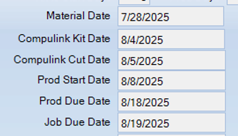

Assuming you are backward schedule the scheduleing engine starts at the last operation and goes backwards to the first operation for the start date. Then if kit time is set that is subtracted to give purchasing a date the material needs to be on the doc so there is time for receiving inspection and put away before the job needs to be kitted.
I have these on a tab on the job like this for us.
