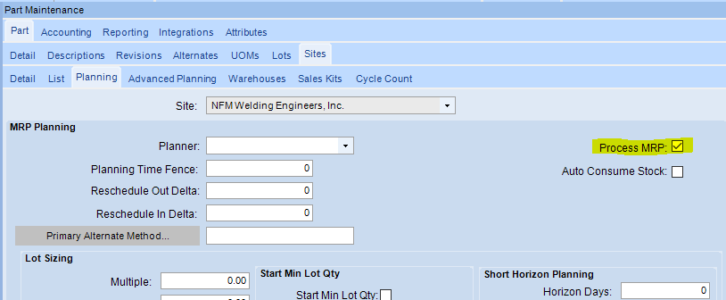

Is process MRP checkbox is on in site/planning?
Are these pars that are made for a parent job, which MRP has created a job for?

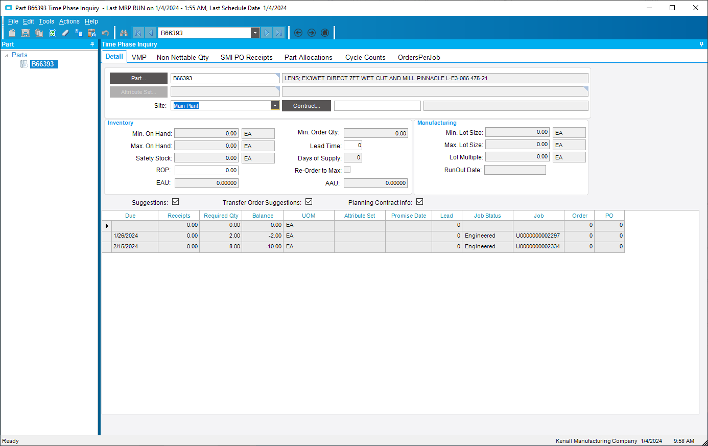

Please post a screen shot of Time Phase for one of the parts in question.

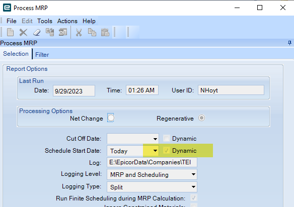

Do you have schedule start date set also? Checking Dynamic/today here is important for our run to get everything and not have some stale submitted MRP date in it.
Nancy
Jarry, I don’t see that flag in Site Maintenance → Planning
Start date is set to Tomorrow(Dynamic)
@Jarry is referring to the checkbox in Part > Site > Planning.
In this case (based on your Time Phase image)… open Part B66393 in Part Maintenance.
Is the Process MRP checkbox checked?
Just checked it, it is set…
