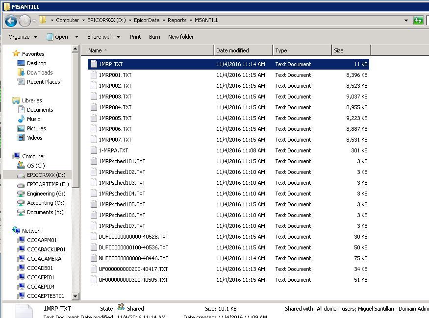

There is data in the PartDtl table, I verified a few Parts as well and they should have gone through. MRP logs indicate that the parts were processed, but just looks like it didnt know about the demand,
