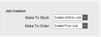

Our settings in site configuration are set this way:
Which by my understanding, should mean jobs that are make to stock would be created as unfirm.

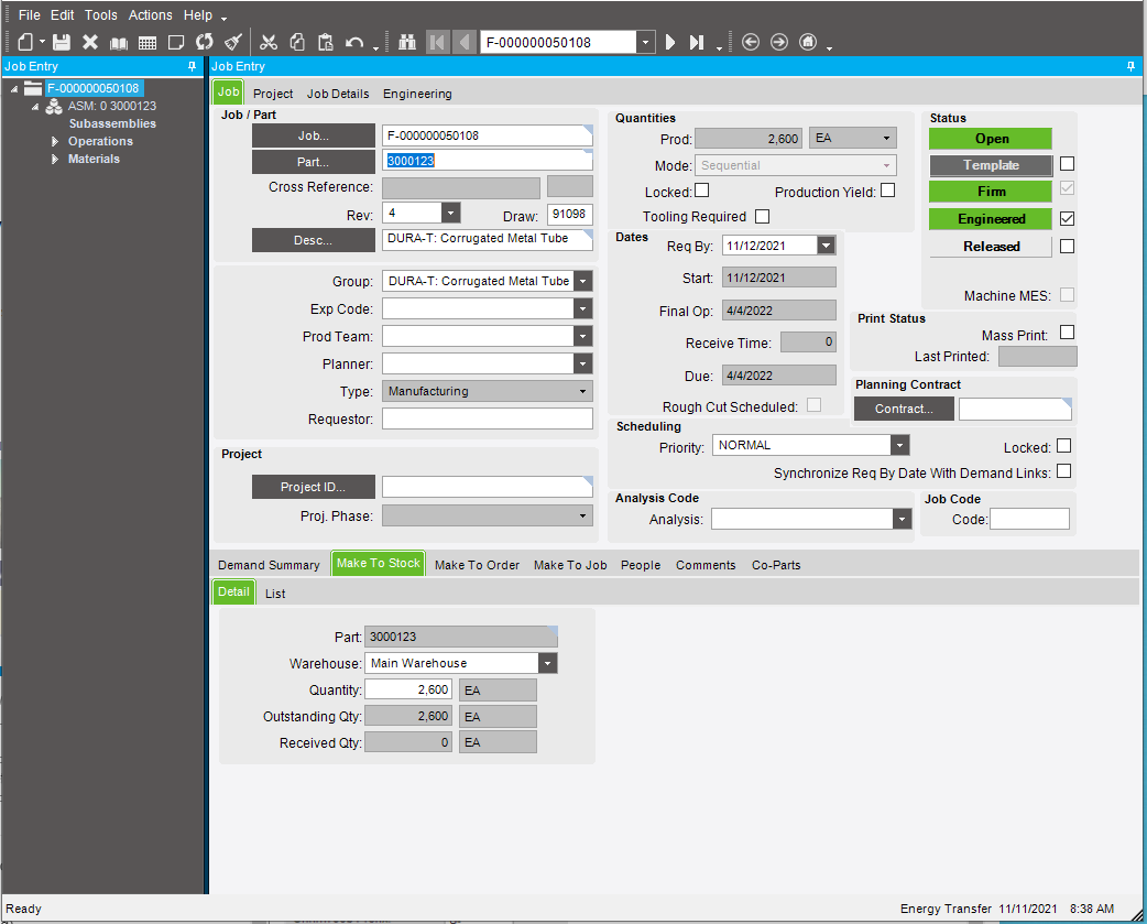

When MRP ran last night, it created this job as an example:
Which is a make to stock job, but it created it with the F- prefix and firmed it immediately:

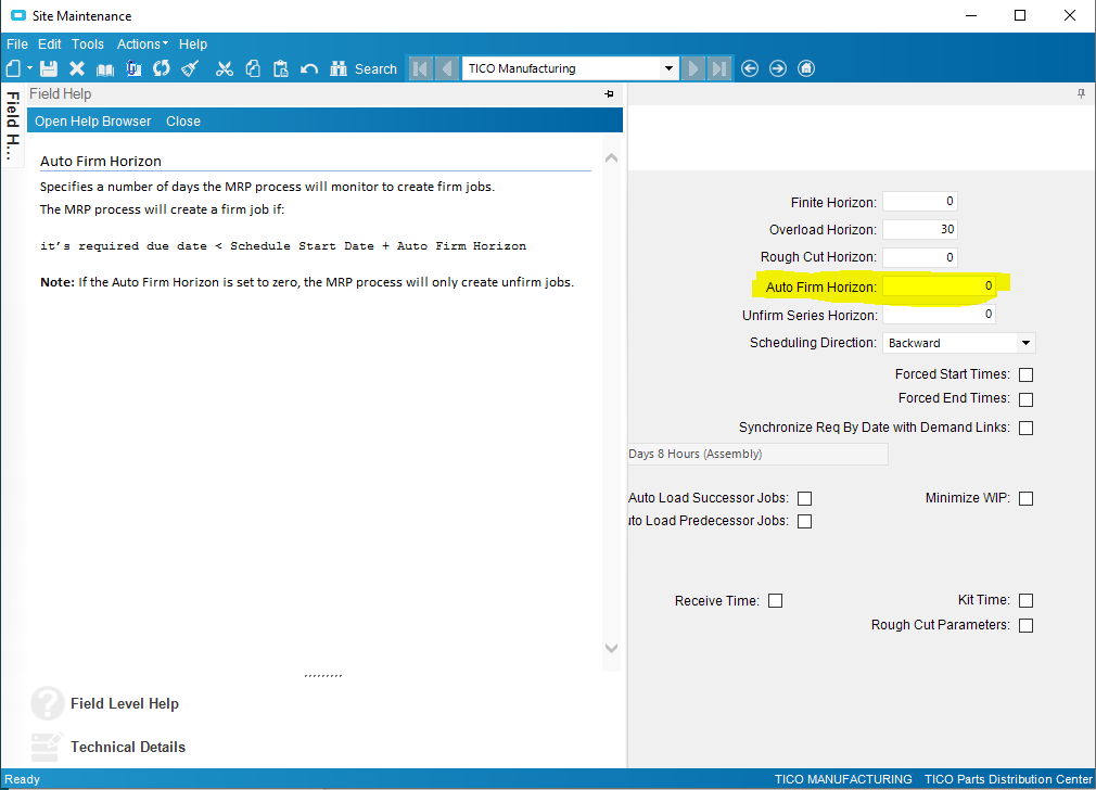

I don’t use it, but it’s this setting, no?
I think you might have solved my issue Jason. When updating my finite, overload, and rough-cut horizons I got change happy and changed these two settings as well which would explain why it is firming these jobs. Made the change and will rerun tonight to see how it goes. Will update with results tomorrow so either I can ask for more help or better yet, show that it worked for others who look in the future.
This was it. I ran MRP last night and it created unfirm jobs. Thank you for the help Jason.
