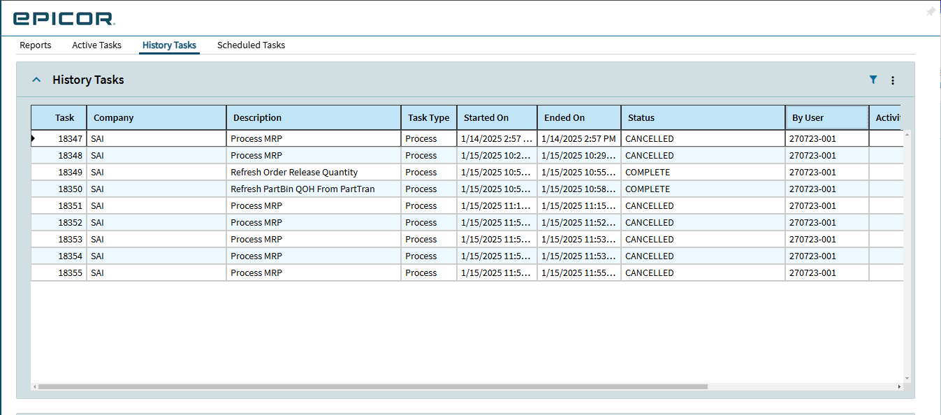

I have a problem when I want to process MRP, the process results show CANCELED.
I have setup all the requirements used for MRP such as creating demands, master part setup, site configuration and so on. How do I fix it or detect where the error is?
I already have the answer, I have to setup a system agent username and password in the Kinetic app, and match it on the system agent server
