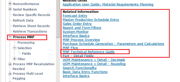

But until you gain access, I’d recommend you review the online help topics (if you haven’t already). Note there is a link to the MRP Tech Ref Guide too, if you need to take a “deep dive” into some specific.
