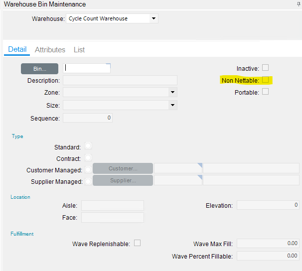

Is that inventory location nettable?
not sure what that means
If this box is checked:
It indicates that MRP should NOT look at this supply as available to fulfill demand. So, it would give you the behavior you are seeing. A job fulfilled the demand but once it closed and the inventory was moved to a non-nettable bin, MRP would order more to fulfill the unmet demand since there is no available supply.

This was it, Thanks!
