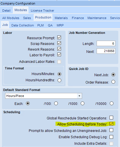

I believe the settings you need is to not Allow Scheduling Before Today under Company Configuration. (It’s checked in mine, I just included it so it would be easier to find.) If you have that set to false, then you can allow historical dates when running MRP and it won’t schedule any of the jobs in the past. Just test to make sure, but I am almost positive this will give you the results you want.
I have tested that, and it does not work as expected. We do not allow scheduling before today, but if this flag is cleared at the time of MRP launch, we do get jobs scheduled before today.
Not an ideal situation in our environment. We are going to use our workaround only when we get customer demand that is under lead time, partly to prioritize the suggestions, and partly to give us the date we originally wanted the material to meet revised schedule.
