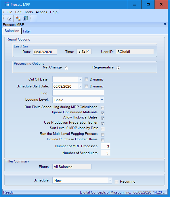

Wondering if anyone else has experienced the issue we are seeing with MRP. We are currently on Epicor 904.507A and in the middle of an E10 implantation. This issue occurs on both versions.
We use Process MRP to generate Unfirmed Jobs. This process typically generates over 250 Unfirmed Jobs. About 1/3 - 1/2 of these Jobs are scheduled incorrectly by where the Req By Date is different from the Due Date so after every MRP run our scheduler has to manually Schedule the Job to correct the dates by opening the Job, hitting Actions - Schedule - Job Schedule… Checking the “Override Material Constraints” option (This option is also flagged when we run Process MRP). The Job is then scheduled just fine with the Req By Date and Due Date matching. Any ideas what we could be missing here? Thanks!

Is the job scheduled to start in the past? You should be able to get the same results from job scheduling as MRP. It will be much easier to find the issue in your E10 instance since you should be able to delete the job and rerun MRP on that part quickly. I would expect it to be a difference in one of the check boxes between the two.
