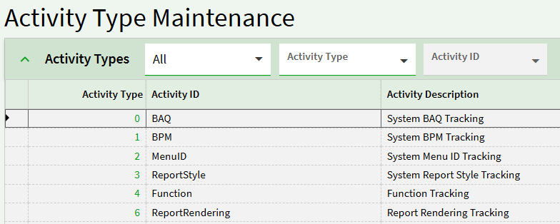

The problem is with activity tracking, I’ve run into it a lot. Open Activity Type Maintenance and try disabling BPM. What’s happening is MRP will run the BPMs regardless of conditions, which logs it into the activity tracking. Very rarely, activity tracking fails SQL-side, which causes those errors.
While this is a useful feature, I have everything disabled (I don’t necessarily need it anyways). The only way I can think to disable per-user would be another BPM in activity tracking somewhere, but would that then also be tracked and cause errors? :person_shrugging:

That did the trick! It actually ran completely through without getting stuck.
