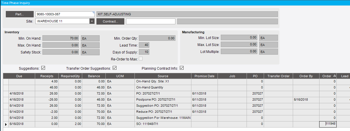

MRP wierdness
I assume you mean the multiple types of Suggestion?
PO, Reduce and Postpone?
I’d suspect MinOnHand… MRP wants to address these immediately and that can interact with other supply/demand dates)
e.g. you might see multiple(weird) suggestions to reduce,postpone, etc…
Thanks Bruce
Lock your PO quantity - those messages will stop.
