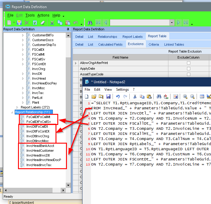

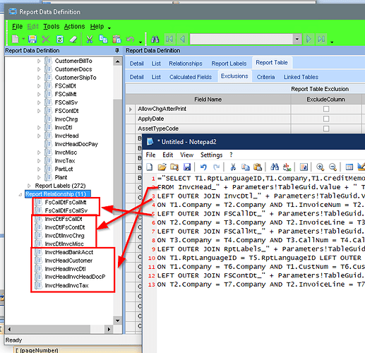

Which table does T3 represent in your version? In my current ARInvoice, T3 represents FSCallMT, which does not contain that field.
If I recall correctly, ARForm has a VERY long query expression. So long, that some have had issues editing it.I just opened the ARForm.rdl that is supplied with 10.1.400, and it’s query expression is exactly 7,000 characters long.
Also, like @Paul_Mayevsky said, that’s probably not the right table. Even though it appears in the 3rd tabel of the RDD, there’s no relationship between the table order in the RDD and the RDL’s query expression.
In fact multiple DB tables are often combined into a single temp table for the reporting
Weird thing is, that none of the table relationships include the CashDtl table (which holds the DocTranAmt you’re looking for).
If anything, I’d try adding that field to table T1.
