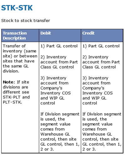

Be careful here. MTL-MTL produces no GL transactions. STK-STK does (see attachment)
Make sure you check your tests in GL to make sure you arent creating other issues
