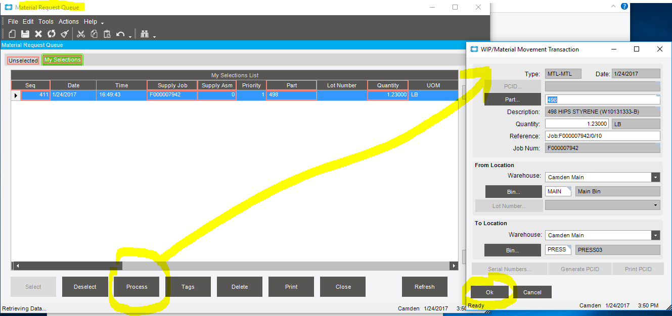

I have used Material Request to add an item to the Material Request Queue.
I select the item from Material Request Queue and PROCESS.
Nothing happens (The screen to perform transaction appears, I click OK). No qty is moved between bins. No part trans record is created.
Am I missing something?

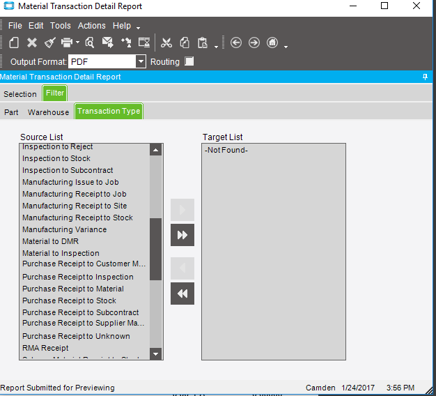

Additionally, I would point out that I went looking on the Material Transaction report, and the MTL-MTL transaction type is not valid.
After more testing, I can confirm that Get Request also does NOT work (PUR-MTL) but a Part Move Request DOES work (STK-STK) when processed from the Material Management Queue
Check back to the Inventory Tech Ref guide for full listing, but I think you want STK-STK.
STK-STK Inventory move from 1 bin to another

The MTL-MTL is automatically classified by Epicor when I request material for a job. You are correct that an STK-STK would process properly. I am considering writing some custom code to force those transactions to become STk-STK in the datagrid and see if they process then. Judging from the behavior I’ve seen so far I think it will work, I just think that in this instance, I shouldn’t have to fix it because this is a core feature unless I’m just oblivious to something.
I played with some other techniques to try to get the concept working, like allocating, releasing for picking, but they all fail because my materials are set to backflush. Makes me wonder if the same conditions are affecting this material queue. They shouldn’t. In order for the backflush to work, I have to give a backflush bin, which means at some point, I need to move materials out of their warehouse bins to the backflush bin. It would be real easy if all my distinct materials resided in unique bins but that just isn’t how our warehouse is set up.
Strange – MTL-MTL isn’t listed in the Inv Ref Guide. The 2 common sources of material issue to job would be STK-MTL or PUR-MTL.

mtl - mtl is for moving parts from one job to another. You are using WIP request which is made to move material from one job to another not from bin to bin. Move Inventory Request is what you should be using.

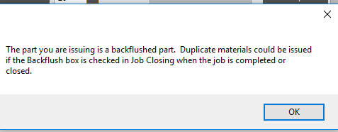

We aren’t understanding why you can’t change the materials to not be set up to backflush? The purpose of backflush is to negate the need for a move like you actually want in your case. If you want to do the move, then remove the backflush requirement and use the system as designed and issue the parts when moved. It’s only one checkbox.
Side note, this message doesn’t actually stop you. It just warns you that if you issue it, it will backflush again when the operation is completed.
