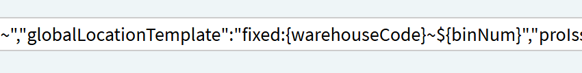

You can find them buried in the selected roaming table for EKW (just build a BAQ for your roaming table and include the fields through character 01) but they are not established on the kinetic side of things; they are set up within your handheld.
Thank you… I feel that the need to have to do all of this on the handheld screen is a GIGANTIC burden for admins.
My trick is to type it up and then use a barcode generator, throw it into a QR code then scan it into the appropriate field.
