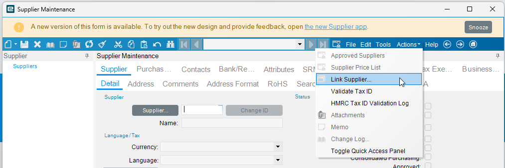

Customers and Suppliers link differently:
Once they are linked, based on the settings in the Global Table, changes in the parent will flow to the linked company.
