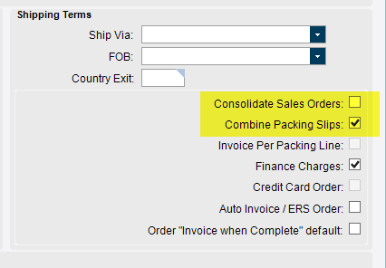

One question. Can you make a single bill for shipments from different sites?
Saul -
We do all our billing from one site.
Shipments from different sites obviously are different packers. There are settings in the Customer Maint that allow you to include multiple shipments on one invoice, and another to limit the invoice to just one sales order.
The settings are on the Billing -> Detail tab of Customer Maint.
The settings above would allow shipments from different packers to be on the same invoice, but only if they were from the same sales order. If I wanted shipments from different packers from different orders to be combined, I’d have to check the “Consolidate Sales Orders” box too.

Hi, Calvin.
we have three sites configured, we have reviewed the option that you give us and if you generate an invoice for two different orders as long as they are from the same site, the shipments otherwise generate invoice per site.
We need to generate an invoice when we have shipments from different sites for the same client.
do you have another configuration or idea?
thank you.
I see what you mean. I did a test of trying to invoice two packers from different sites, and it created two invoices.
While we often ship from multiple sites for the same order, we rarely would want these to be on the same invoice. In the cases we do want it, we do a Misc invoice (but that has its some of its own problems).
If I remember correctly, I believe this is functioning as intended because shipments from 2 different locations can have 2 different tax liabilities and tax is calculated at an invoice and is related to where goods are shipped from.
