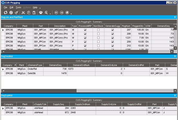

Can anyone offer any help on how to join these properly?
Casual glace, looks like Company and DemandSeq or SupplySeq depending if you’re linking to PegDmdMst or PegSupMst
I can offer the attached BAQ as one way to join the tables.
MultiLevelPeggingAnalysis.baq (27.0 KB)
And here is a simple dashboard using publish/filter and 3 BAQs
CUS-PeggingRawData.dbd (220.7 KB)
