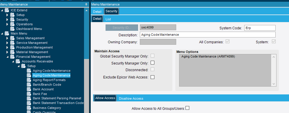

We’ve gone to menu maintenance, but the ability to set Owning Company is greyed out, and “All Companies” is always checked. We really would rather not go through every single setup menu item to set it individually via Allow Access Groups/Users.We’ve also tried “Actions > Add to current company”, but it’s also “All Companies”.

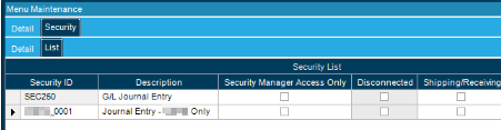

We’re making some progress. I also put in an EpiCare ticket where the fix was to go to Menu Maintenance > File > New > Security. I added a new security ID which was company specific, named it CompanyB_0001 to not step on Epicor’s security ID. Click save, add the company specific security group as “allowed”. Save and Close.
Re-open, and the 2nd security ID disappeared from the menu item! Bug? Or am I doing something wrong?
If I try to add it again, I can find it from the SecurityID button search, and re-add it, but it always gets removed when I re-open (and the user can’t access the menu item).

This (yellow highlight) is where you say “this menu item has this security.”
The Security list view is NOT a list of all the securities(?) associated with that menu item. It’s not. Really.
When you add one and multiple rows are in that grid, it’s only for your reference.Yes, it disappears immediately after you close the screen.
If you ever needed to modify one that existed and you already “lost it” by closing the screen, I guess you would need to assign it to a menu item (yellow in pic) and then modify it.
