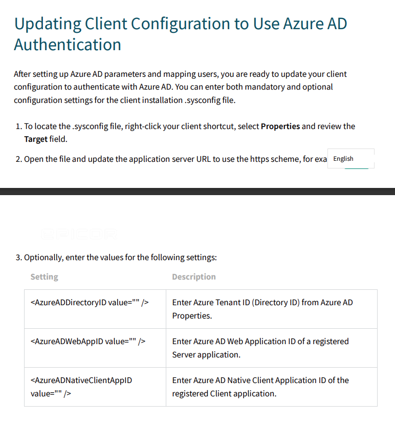

-Will there be a need to update sysconfig file after the new Directory ID is created?

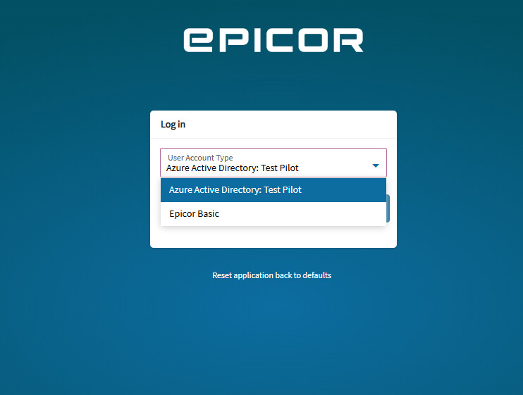

-I am not positive, but I would think that if you have multiple Azure Active Directory settings then there will be multiple dropdowns at the menu startup on the web. Not sure how it would work on the application with the sysconfig.

I would imagine you have a dropdown list like the one I have listed below for the web. The user would then just select either the old directory if they are using the existing Directory or the new one for new users. Perhaps support would know if you can multiple Azure Directories for the application but I am not sure. I would them imagine that the external ID would then link to whichever Directory the user selects.
