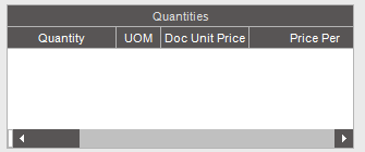

When you are on a line in the quote, do the new drop down and select “New Qty Break”. You will get a new row in this:
Enter the quantity for the new row. Select the row in the box and go to the cost worksheet to see the cost for that quantity.
