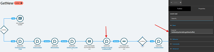

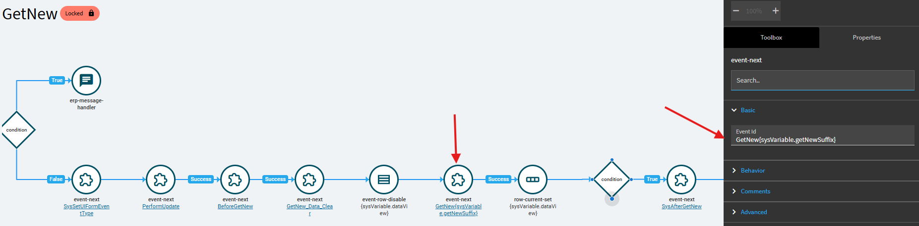

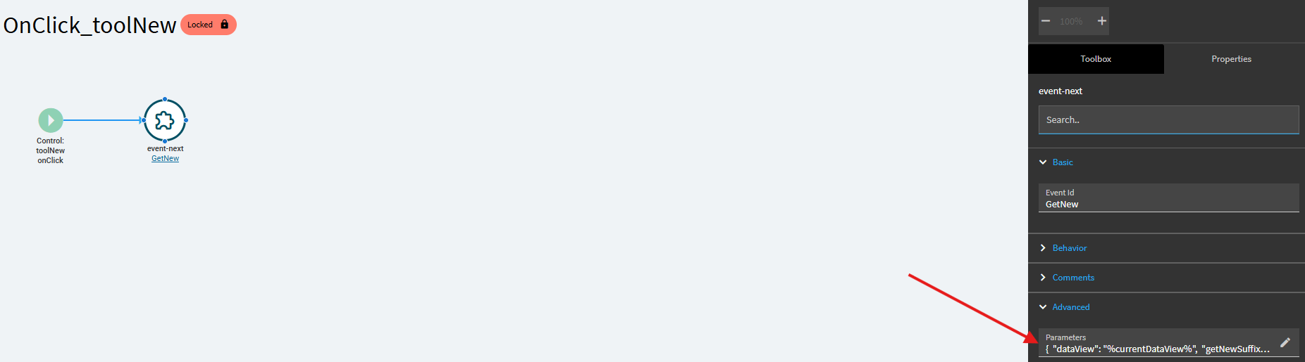

On Part Entry (since I’ve wrestled that demon before), the New button is used across the application, but the event(s) include a “switch” of sorts. First the OnClick_ToolNew event triggers the GetNew event… but it does so by passing some parameters which sets the “dataview” and “getnewsuffix” to the dataview the new button was tied to.
In the middle of the GetNew event, there is an event-next with a value of:
GetNew{sysVariable.getNewSuffix}
This effectively runs a GetNew{currentdataview}… so if the new button was bound to Part, or PartRev… it would trigger GetNewPart, or GetNewPartRev.
In our case clicking the plus button on a grid bound to UD02… that becomes GetNewUD02

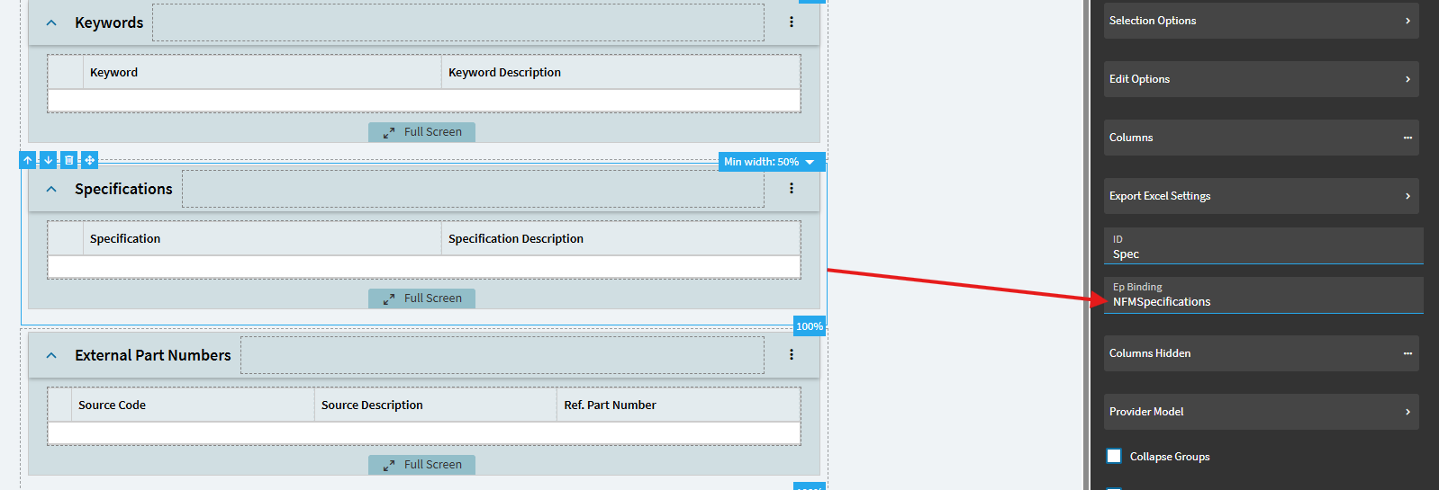

The plus button appears when your grid is tied to a DataView in the Grid Model.
If I delete that binding, my plus button disappears.

What we did for this form was to actually populate each of my (5) grids by BAQ/DataViews. Each grid has its own BAQ which only returns rows from UD02 with the proper keys.
But, because they’re tied to their own dataview (bound in the grid model), each grid gets it own “plus button”.

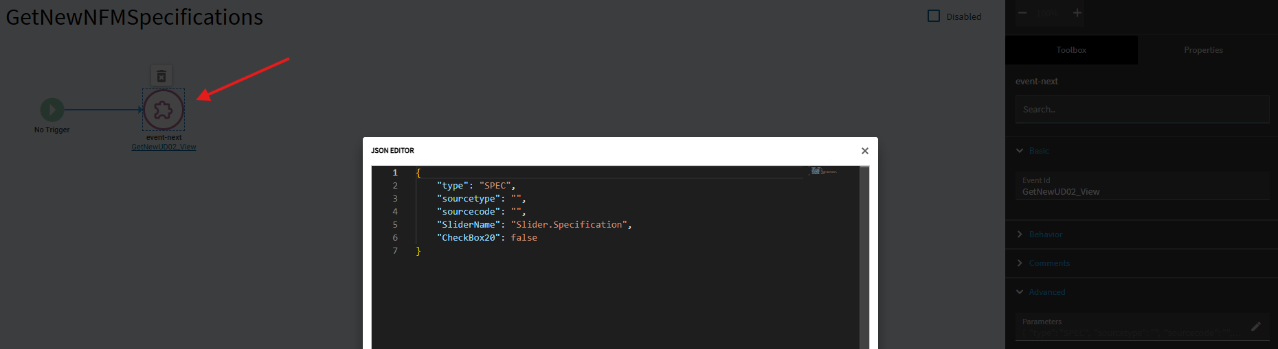

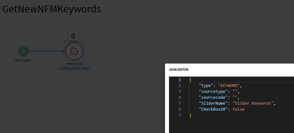

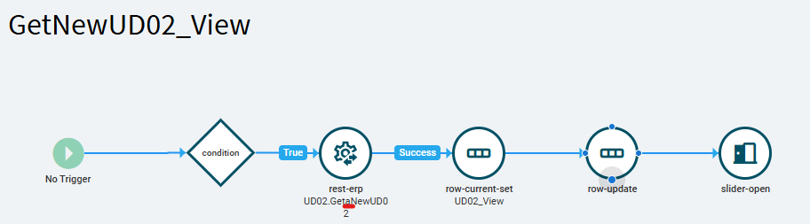

My GetNewNFMSpecifications event performs another Event_Next which calls up our “master GetaNewUD02 Event”. But we added our own set of parameters on the Event-Next action.
Below are the parameters being passed to my master GetaNewUD02 event if I click the plus button on my Specification Grid.
But… had I clicked the plus button on my Keywords grid… that results in passing different parameters to my “master GetaNewUD02” event:

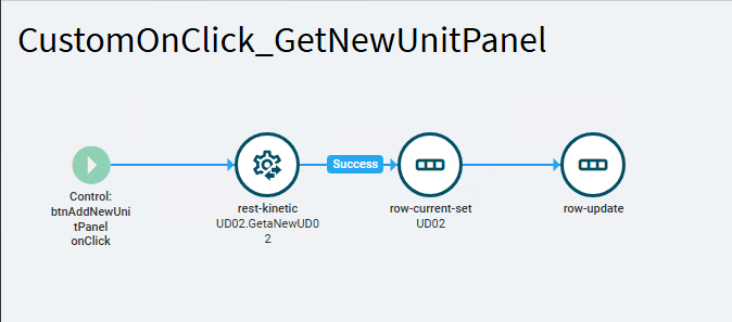

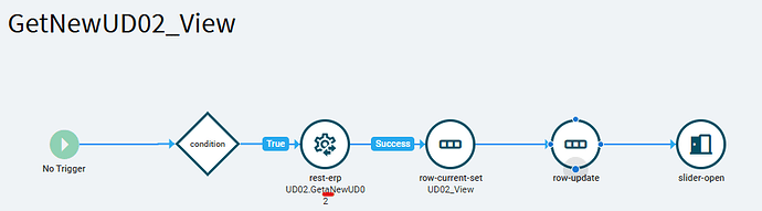

Below is my actual GetaNew event:

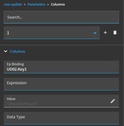

I check to make sure the PartNum is valid, then perform the GetaNew rest call, this new row is created on my UD02_View dataview (it is the only row in that dataview). We set that new row as the current one (may or may not be necessary) and perform a row-update. This is where I use some of those parameters we created earlier…
I set Key1 to a value of “{Part.PartNum}”
I set Key2 to “{SysVariable.type}”
I set ShortChar19 to “{SysVariable.sourcetype}”
etc.
It THEN open up a slideout which contains additional entry fields tied to various UD02 columns for the user to input more information.
We then have a save event which performs a UD02Svc.Update call to save that new record to the UD02 table. At the end of the save event, I have another event that refreshes all my BAQs. They re-run, re-populate their respective dataviews, and the grids then update to show the new records.

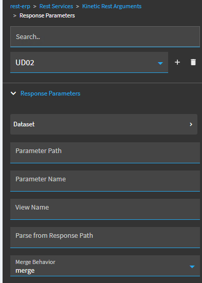

So I ended up doing something similar to what you have but some minor differences. I would have liked to use the inherit GetNew on the BO but this seemed a little easier.
I disabled the GetNew on the UD02 dataview getting rid of the plus button all together.
I then added a button on each grid for the “Add New” functionality. I created an event for each button which are all the same except one thing and that is setting Key2.
I call the GetNewUD02 which creates a blank record and I set the Merge Behavior to merge because it was clearing the dataset when this method was called. This is another reason I abandoned the BO because it was clearing the entire dataset to add the record. It never did that in .NET. Not sure why it would start now…

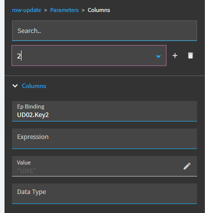

The one difference of all three events is in the row-update event where I set Key2 to the unique identifier “COMP” or “HP” or “UME”

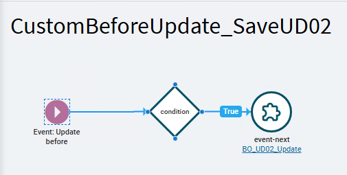

I then created a custom event to tie to the BO save so the user would just hit the save button as normal. Here I have a condition that if RowMod = “A” on any row then to call the UD02.Update. The target is set to the BO before update, which I may change to after depending on user testing. But you get the idea. I basically wanted to tie to the BO save to avoid an extra user click.
