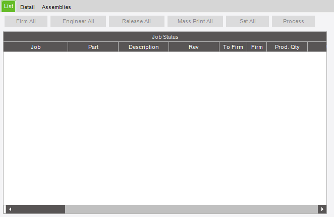

Yes. One area is Job Status Maintenance.
Also check if someone has set the Auto Job release process to run
Production Management / Job Management / General Operations
There are many more ways to release jobs - planning workbench, quick job entry, order job wizard to name a few more. I would look at a data directive instead. Also think about what happens if a job is un-released, since that happens too.
