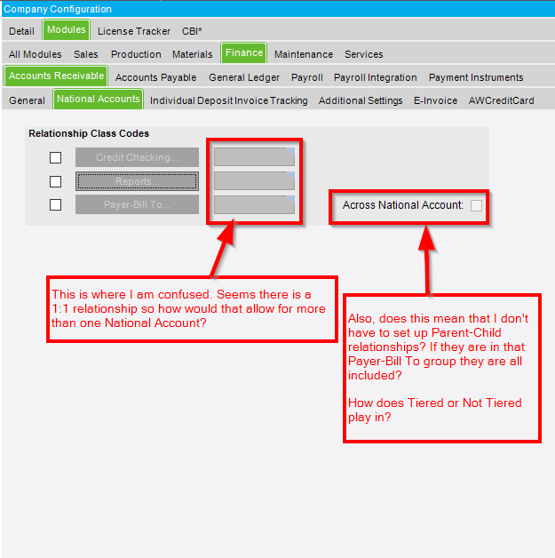

My questions continue on the actual set up too. If you have one payer-bill to seems that is ONLY one to be used. Or do you set up a code MULTIPLE and then within that have NATACCT1, NATACCT2, so on and so forth?
Also the clarification Across National Account - how does this apply to the code and where does tiering come into play. Sorry to ask, but trying to learn and comprehend.

Tiered is for parent/subsidiary companies. In other cases it can be non tiered. The check box “Across National Account” is selected so you can process payments irrespective of the relationship being tiered or not.
Help for the check box “Across National Account”
Accepts payments from any customer within the same national account, regardless of parent-child status.
We have this check box selected and use only one class for all three and are able to process single payments for all the customers in that class.

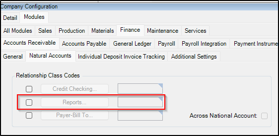

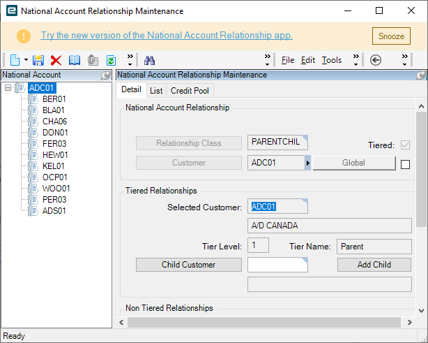

It does not matter who is at the top ID. You have to add parent and child customers under AR>Setup>National Account Relationship. It should show as under:
@Jonathan this is what confuses me… the company config stuff isn’t clear about what it’s doing and when. Do you really need to set these for it to work or is it like the GL controls in company config that are just defaults should everything else in the hierarchy be left blank (i.e. part class, prod grup, etc.)
In other words, what if you don’t set anything in company config, isn’t it all still defined by what you have set in the relationship and customer record?
It’s almost as if the instructions are saying , “you can only have this relationship code (and it’s settings) as ‘payer-bill to’ and this relationship code as ‘reports’ and this relationship code as ‘credit checking’.”
Almost as if you can only have ONE type of national account relationship for all customers in your database, but that’s just not true right?
You can create different types of national relationships. I do not think the feature will work without having classes in the Company Config. In our case we created only one class and use it for all three. We use this mainly for single payment from customers. Your use case may be different.

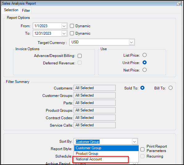

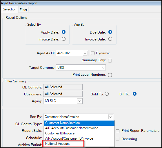

I don’t think the reporting feature works unless you have it defined at the Company config level. Then what ever class you have defined there can be used in the default reports to group on.
Aged receivables
Sales Analysis
So my question is, does that reporting option use the national account that’s defined at the customer level or the company level?

It will only report on what is defined at the company config level. If you do not define a relationship class in company config the default reports error out when you select the “National Account” option. This is why I was going down the path that I might need to assign Multiple Relationship classes for each customer depending on what we needed. Some we need just reporting, others payer bill to and a few have credit sharing.
