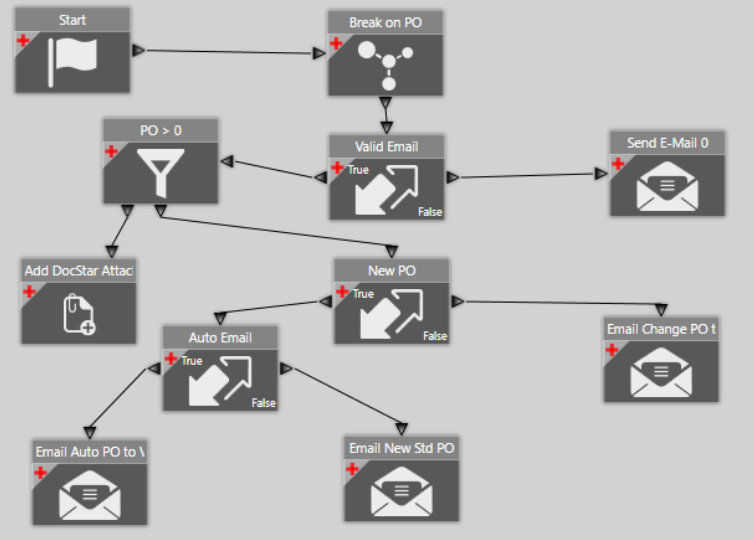

@1x767rk Welcome. APR or auto print routing is the way to handle this. In the report style POFORM create a new style, then you can setup a workflow. Mine is below.
